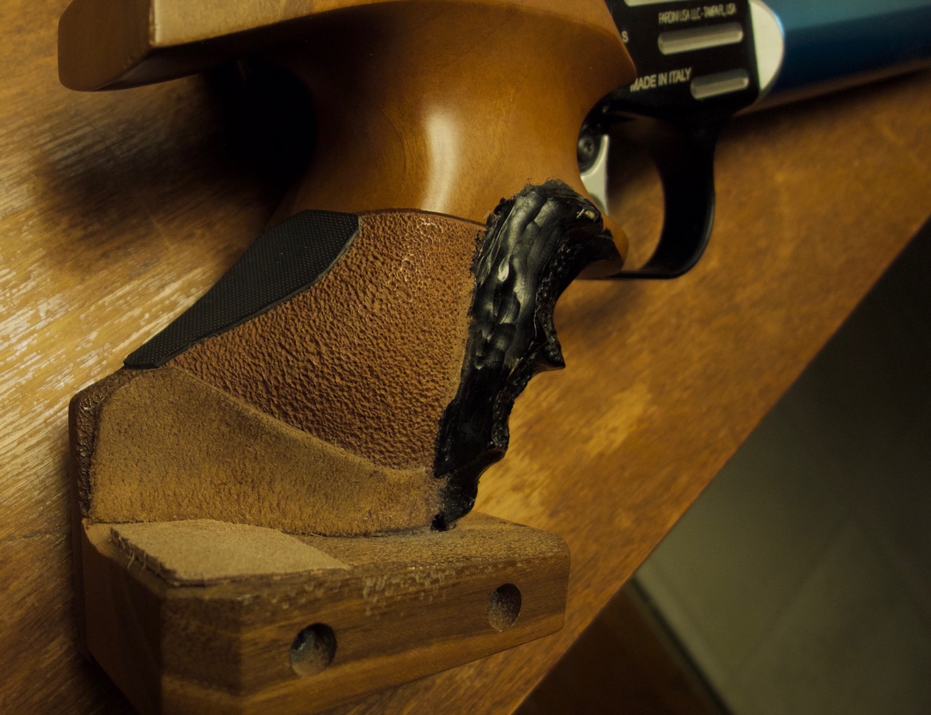

So where does THIS ATROCITY fit into the Pantheon of "Pretty Grips" - I think I went for function over form on this. It's formerly known as a Steyr medium grip, then add Morini putty, a heap of Devcon #10110 Steel-Epoxy, grind it, file it, sand it, then slather some more putty on it, coat my hand in wax & grip fit it, then sand clear-thru the top of the grip (pictured), then add more putty & attack it with the brass brush on a Dremel.
Re: Get a grip, man!
I don't consider this "violating" the grip. It's more like making it into a grip.
