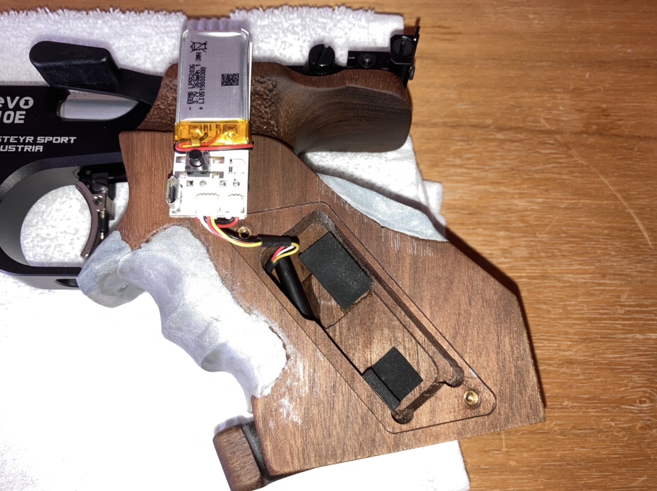

Have you looked behind the small circuit board? There should be two pieces of foam that supports the circuit board. If the top one is missing, I imagine a problem like yours may occur.
The connection always feels a bit mushy, due to the foam behind the board, but I have never had a problem connecting the micro USB into the gun.

Thank you for this picture. That foam was not there. Hard to believe that it would be sent out this way on a brand new gun. However, it's an easy fix.
