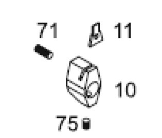

How did you remove the blade? Did you tap it out?
Posts: 3573
Re: Centering the front sight on IZH-46m
If you have removed screw #71, the front sight blade should just lift out. The screw has a pin on the end that goes into the hole in the blade, so loosening the screw is not enough.
IZH-46M Front Sight Assembly.jpg (7.53 KiB) Viewed 1910 times
