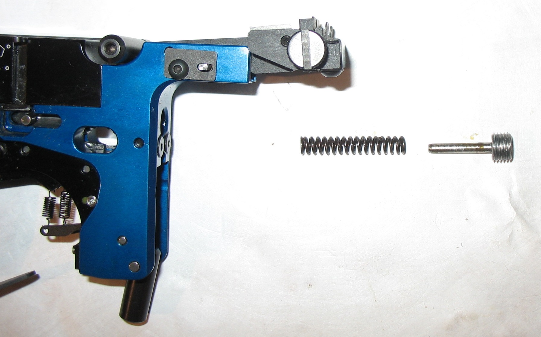

I took out the hammer spring and spring guide also came out. They both look brand new. I reinstalled them and put tension screw back in, no change, adjusted the screw, very little change, much more change when I adjusted the air pressure regulator screw. Still waiting for Match Guns in Italy to reply. They said they are still in Virus shutdown mode until maybe April 9, maybe.

See attached picture.

I have an MGH1 and I have found the velocity changing on it own. I set the velocity to 535 fps and it was very consistent over 15 shots it varied just 2 fps but two weeks later it sounded soft when I shot it. After checking the speed again, I found it was recording 467 fps when adjusting the part to increase the velocity it moved very easy with no resistance. When adjusting an LP10 there is a small grub screw that locks the adjusting screw but on the MGH1 there is no such screw they just hope the spring compression keeps it stable. I think Match Guns should think about a locking screw on the velocity adjusting screw.
Having seen the picture on the previous post I am now going to remove the adjusting screw and check the spring.
