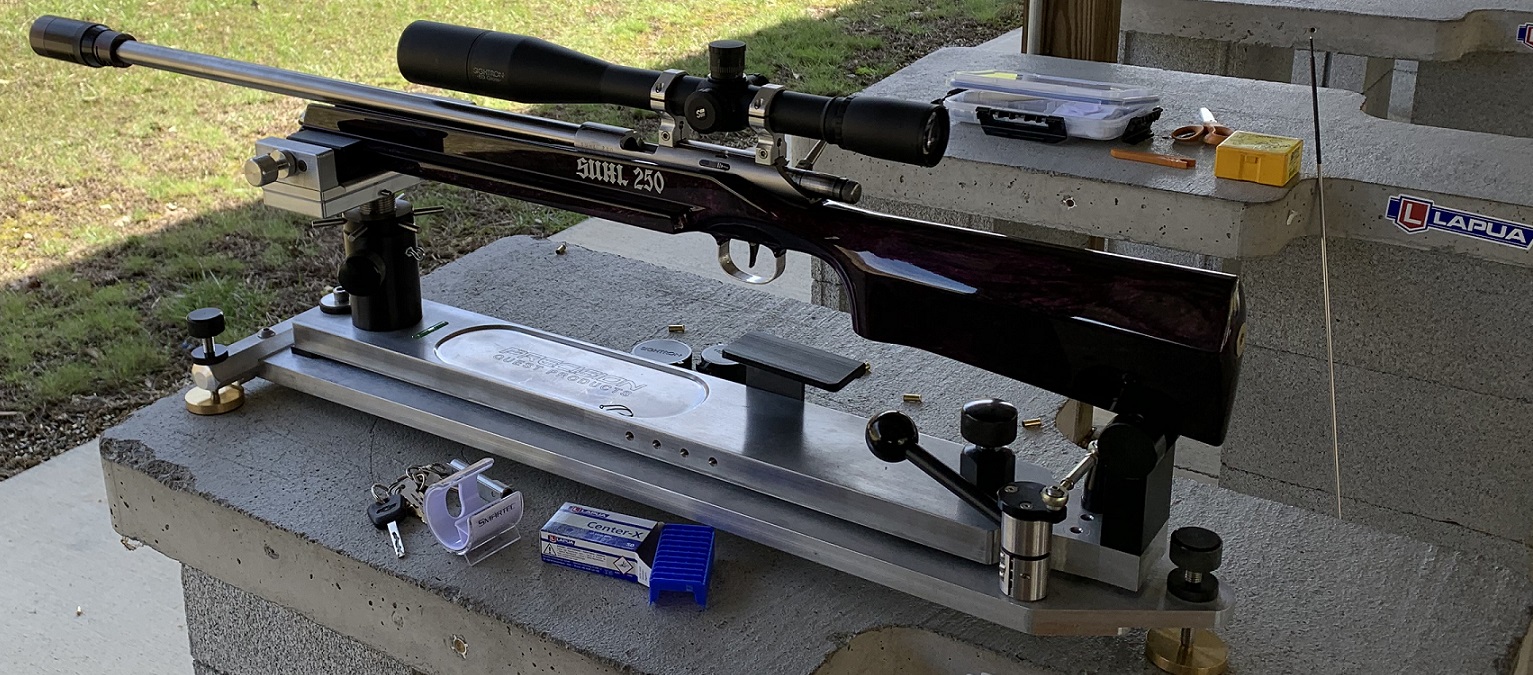

Yeeup.. just had Howard do a bedding job on my Myers rifle.. it is shooting fantastic!
