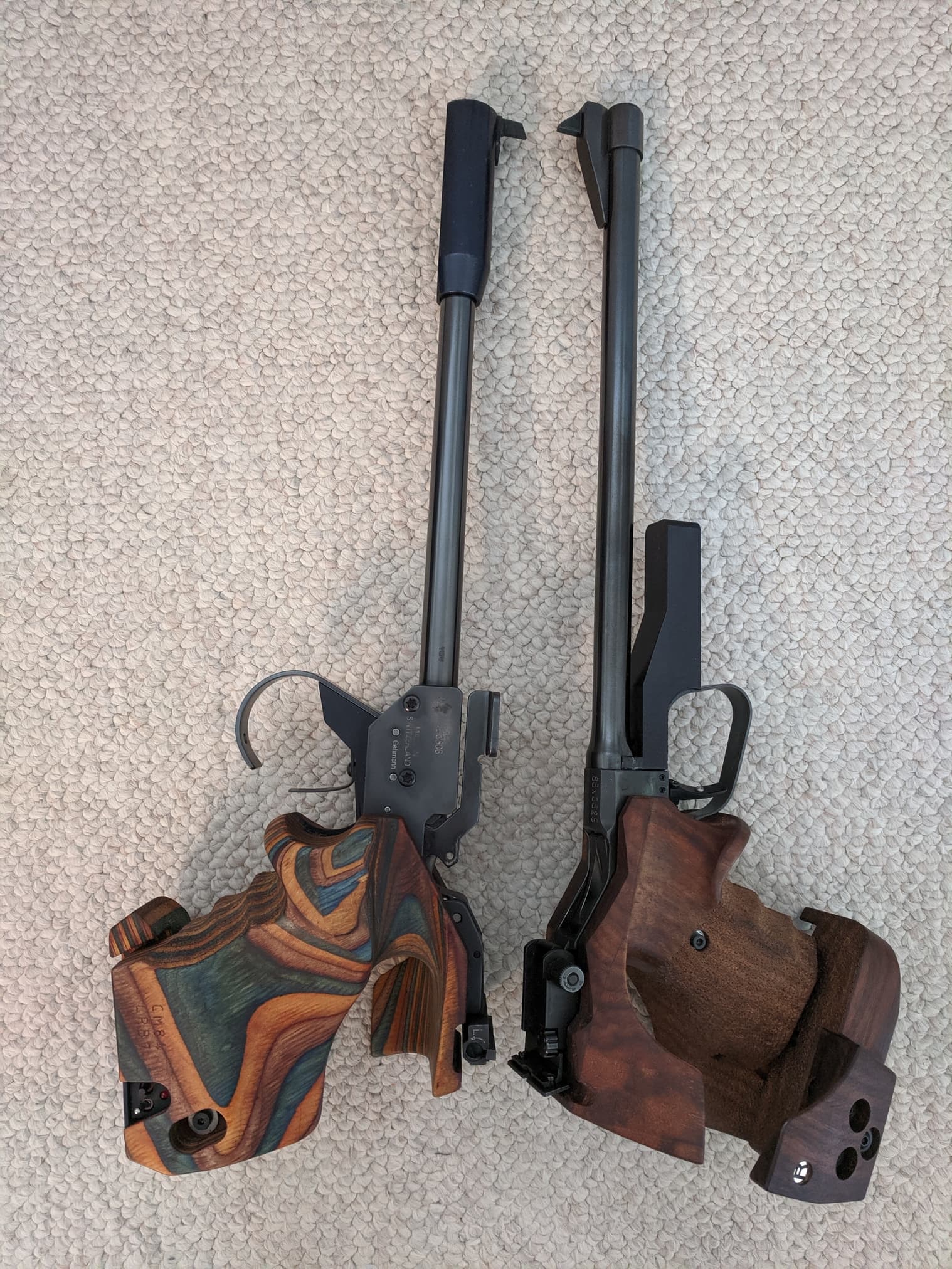

@sparky
You can see from the picture in my last post that I have tried to move the bloop tube on the Morini to (roughly) match the length of the Toz barrel.
The front and rear sights have also been machined to match.
Could the lock time for an electronic trigger be substantially slower than the mechanical one in the Toz? And if this was the cause of the different behavior, wouldn't the Morini have a large group overall? (see Morini - botton vs Toz - top pictures)

There are two factors at play here, first, the curiosity of two pistols apparently very similar that exhibit a different behavior.
This HAS to boil down to one or more physical measurable quantities.
The second, on whether one behavior may be preferred over the other when learning the discipline (sure, everything is a matter of preferences, yet some are or maybe more preferred than others).

- Toz.jpg (30.85 KiB) Viewed 7604 times
- Morini.jpg (34.75 KiB) Viewed 7604 times

I think one of the important parameters (which is also hard to measure) is the "moment of inertia". If you model the pistol as sticking out from a pivot point (like the wrist), the higher the moment of inertia, the less it will rotate for a given twitch on the shooter's part, and the less it will move in response to internal forces (firing mechanism thrashing about), and recoil.
Just from looking at them, the large muzzle piece on the Morini should give an advantage in this regard, even though it's made out of aluminum. However, if you believe Mr. Poddubny, then the exact opposite is true.
I spent two years trying to quantify the mechanical properties of the Benelli MP90S that made it more "forgiving" than my Pardini SP. My daughter had commandeered my MP90S, so I had it available to study, but not compete with. I finally gave up and just bought another Benelli. My scores immediately improved.

With the identical sight radius, shorter barrel, and I would assume same or quicker lock time, I'd think the Morini would be more forgiving...go figure.gimgim wrote: ↑Sun Jun 23, 2019 12:44 pm @sparky
