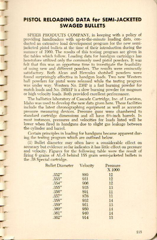

Here is a scan of a Speer test regarding bullets of different diameters and resultant pressures.
Must be a difference between Semi-jacketed and Lead bullets...
