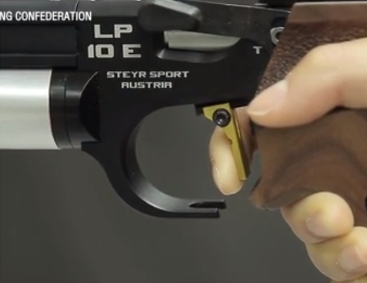

The attached pic is a part of a screenshot from a Korean training video (see https://www.youtube.com/watch?v=EP5C_3KiPpg) which teaches about trigger pull. At approx 3.10 mins in and at other points various close ups of the trigger are shown both for the Morini 162Ei and the Steyr Evo etc. The attached pic is part of that and shows an unusual trigger shoe being quite straight. I won't discuss the advantages or drawbacks but note the notch for the trigger weight check which appears higher than half way up the blade whilst the finger position is quite a bit lower which will give a considerable reduction in pull weight from that measured. Whilst this can apply I guess to any trigger blade, the standard Steyr issue has a pronounced curve (more so than Morini) which does not allow a straightforward contact lower down the pad. The one shown in the pic would still allow a straight back pull anywhere from the top to the bottom of the blade. Good idea me thinks...
Any idea where these might be obtained from? Scanned Korean shooting outlets (what I can find anyway) but to no avail. Might have to get the old Dremel kickstarted and create on myself perhaps.

cobbs wrote:the notch for the trigger weight check which appears higher than half way up the blade whilst the finger position is quite a bit lower which will give a considerable reduction in pull weight from that measured.
Thats basically cheating, or at least not in the spirit of even competition, from the ISSF rules its clear that the mid-point of the trigger finger pad is the position to measure the trigger weight.
However for a flat trigger its not crystal clear, the rules need to catch up.

An interesting difference between this 'putter' blade (and also the Morini) which is not adjustable and the Steyr which is. The measurement point of the latter always moves as the shoe is repositioned vertically but the putter does not. Advantageous?

If you think of the entire trigger assembly under the frame as a lever, it looks like the notch is actually in the middle, so perhaps this is not cheating and trigger blades that adjust up and down offer a disadvantage.

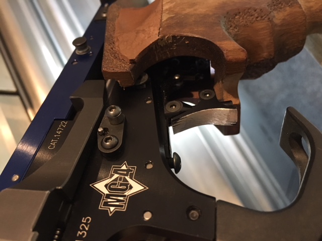

The Centra Putter on my LP2 ...
Trigger weight on an LP2

What if you don't have a notch? You should be okay if you aim for about 1100g weight.
