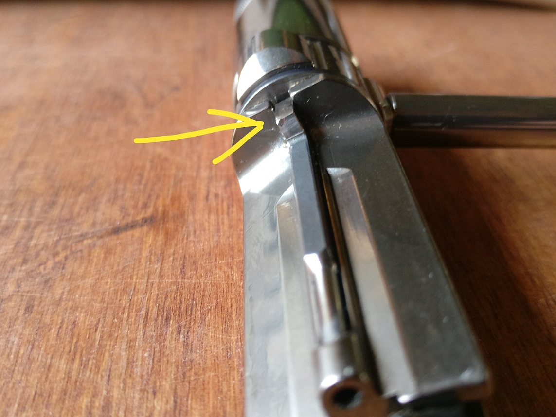

I experienced some issues with my Walther KK500-M Expert rifle yesterday that had me confused and concerned.
After 11 shots the trigger suddenly stopped working. It passed the second stage and nothing happened. The firing pin seemed to be properly cocked in position ready to fire but never released.
The only adjustment I've made to the trigger from the factory default is to lower the second stage weight (F2) by one full revolution of the screw. I've shot upwards to 1000 rounds with this setting without any issues.
I cocked and uncocked the bolt several times both in the rifle and outside and it seemed to behave properly but still didn't fire when I retried.
There's only two things I can think of that might be out of the ordinary.
First I inspected the bolt and firing pin next to a team mate's and found that there is what looks like a tiny nick on the firing pin "locking heel".
Possible issue on bolt
And second we had really high humidity outside at the time (about 95%). But I believe that the rifle would not be affected by that so it's a long shot...
After about 10 minutes it suddenly started working again without me having made any changes to the rifle, bolt or trigger.
The bolt has always been stored in the case it came delivered in between uses.
Any ideas what might have caused it?

Just a few suggestions - I would use a small fine honing stone on the "nick" you found to make sure it does not have a small burr catching on the trigger sear. I would remove the trigger, clean it in naptha and blow it dry before reinstalling. Also make sure the overtravel stop is not set too close to the release point. The sear obviously did not release the firing pin.

beye wrote:Just a few suggestions - I would use a small fine honing stone on the "nick" you found to make sure it does not have a small burr catching on the trigger sear. I would remove the trigger, clean it in naptha and blow it dry before reinstalling. Also make sure the overtravel stop is not set too close to the release point. The sear obviously did not release the firing pin.
The nick seems to be flush so there's nothing to catch on. I'm not sure I'd dare to put a honing stone against it or clean the trigger as you describe, it's just a couple of months old and I'm not yet comfortable taking it apart to that degree. There is quite a bit of overtravel so that seems doubtful that it'd be an issue. Thanks for the suggestions!
