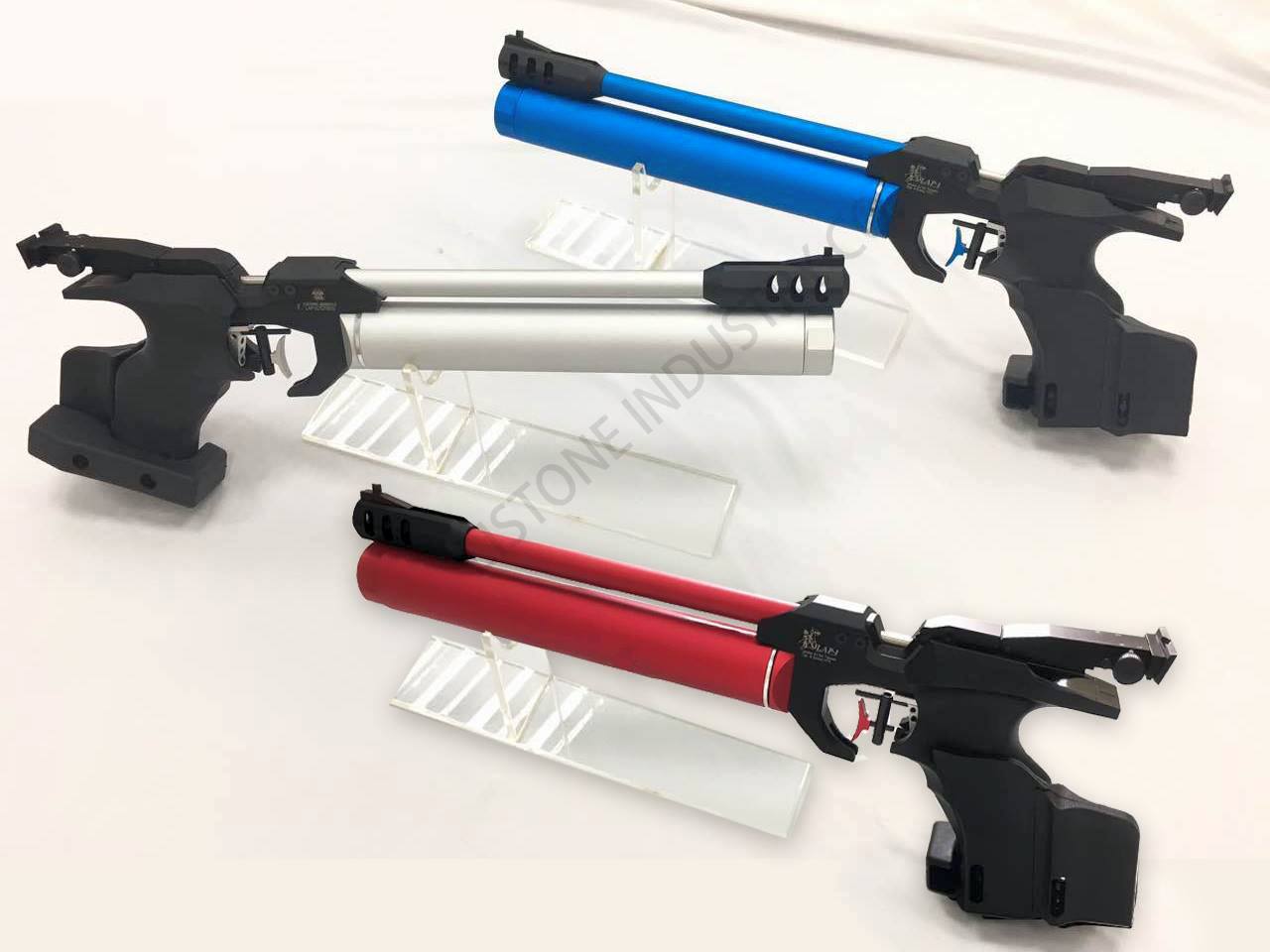

A bit off topic, here's a taiwanese copy of the LP400 that sells for considerably less than the original. (looks like a hybrid between a LP400 and the AP20):
Listone LAP-1 PCP Air Pistol
