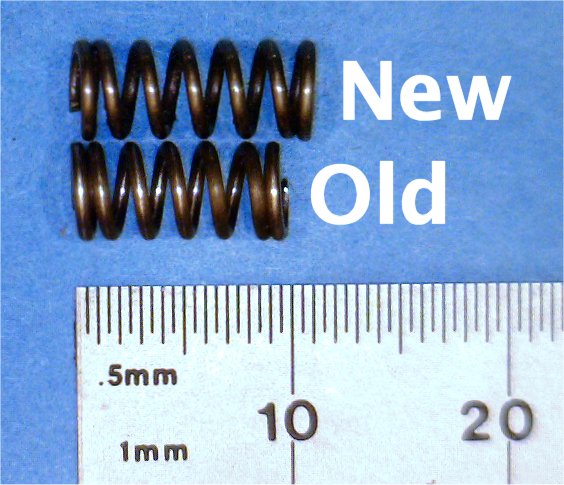

I just measured several:GKU wrote:I have the Breech Flopping Closed When Cooking issue with mines ...... thanks Gwhite for posting/giving the PDFs fixes !
Will the replacement of this Valve Spring - (#13) #300314 have an effect on the velocity ?
Also does anyone know the spec measurements of this spring ?
~ Thanks, GKU
Length: 11.5 mm (0.453")
Outside Diameter: 4.70 mm (0.185")
Wire Diameter: 0.72 mm (0.0284")
Turns: ~ 5.5
There are 5 full turns, plus a little extra. The ends have the last turn closed up against the previous one & then ground flat. If the action is cocked when the pistol is stored, the spring can take a "set" over time, and compress:
Re: IZH 46M malfunction
Thanks Gwhite !
I removed and looked at my valve spring and it was very close to its factory spec.
I remove part #12 slide latch spring and cut off a couple of coils.
Bent coil closed up against the previous one and ground flat.
It's new OAL is now 24mm off it's original OAL of 34mm.
Breech Flopping Closed When Cooking use to occured about 50% of the times, now not even once yet.
I bought an extra slide latch spring just in case.
~ GKU
~ GKU
Thanks! That's good to know. I suspect a lot of the problems stem from a combination of marginal heat treating of the springs, and storing the pistols cocked and/or with the breech wide open.
I never stored my IZH cocked only with the breech latch open to help the 2 breech seals from compressing/deforming with long term compression.
Also, I was reluctant to add that I removed about a coil at a time or 5mm and retested.
All IZH I suppose will be a bit different so it might stop there ?
With my IZH it helped and improved from the 50% to about 80% of the times when cocking.
So I removed another 5mm to get 100% for the breech to stay in the open position after retuning the cocking arm to its closed position.
Far as I know this spring’s tension seems if to great will add/aid to the forward momentum on the breech arm when returning the cocking arm to the closed position. The faster one closes the more pronounce this effect becomes. I believe age and degrading tension on springs involved along with breaking in and smoothing out of parts can contribute to this imbalanced issue.
~ ATB, GKU
