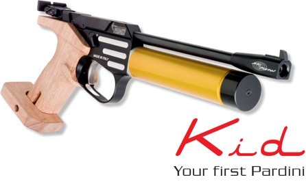

.... and also the Pardini "Kid", which is around 700 grams, and the Benelli "Kite-young", which is around 750 grams. s.
- kid.jpg (23.4 KiB) Viewed 2768 times
