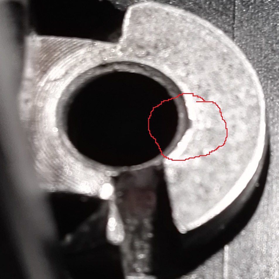

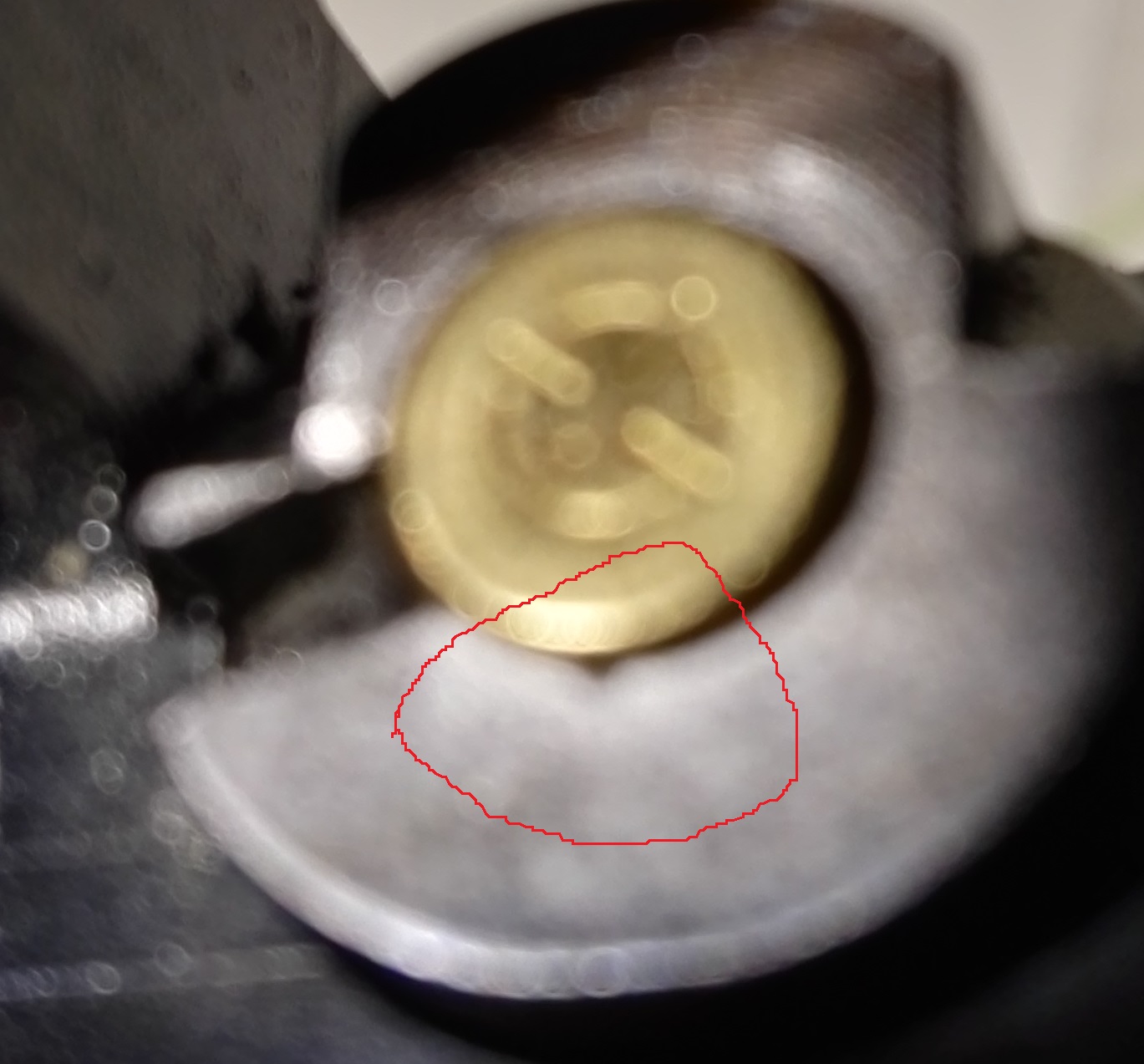

I tried taking some pictures, although the quality may not be that great, it was quite hard to get the camera to focus properly
It is quite difficult to see, but there is a small mark on the chamber. The mark looks to be exactly above where the firing pin strikes the round.

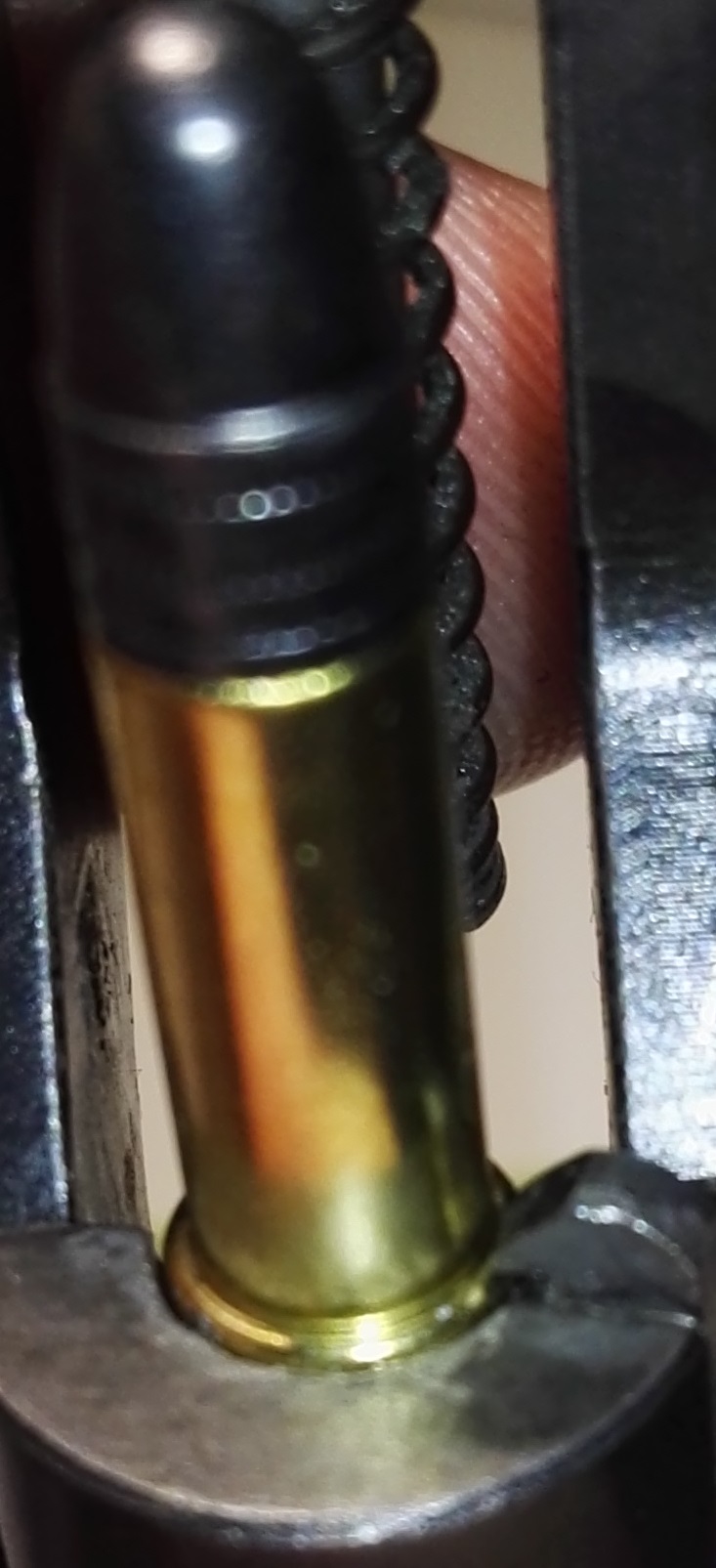

The extractor does not grip the round at all, even the slightest tilt, and the round would fall of the bolt face. I guess new parts are pretty hard to come by. Do you think a possible fix could be to have a gunsmith machine a new extractor? (are they just a "piece of metal" or would they be really difficult to make?)

On a blowback pistol the extractor does not usually do much anyway, so I would not attribute that to your failures. You may find removing the extractor will improve things.
Is the chamber totally free of carbon? Looks like the cartridge is not seated to depth...
Swapping between cartridge types can make this problem a bit worse. Skirt, ogive, and powder all make a difference to the situation that occurs in the chamber.
CCI Standard is grunty enough to blow itself out even with a bunch of crap in the chamber. SK is very nice ammunition, but less power means the mechanics of the pistol have to be well sorted.
I wouldn't worry about the firing pin mark on the chamber, that is not deforming anything.
An extractor is just a bit of metal should not be hard to find someone to make you another one with a longer nose.

It looks like the extractor is just a flat piece of metal, which is pretty common. A good gunsmith can make a new one, but it's fussy work & won't be cheap. I'd work first on making sure there is no crud or a weak spring preventing the existing one from hanging onto the case. If you push outward on the extractor tip, does it feel smooth? Does it require much force? If you can push the extractor sideways with the tip of your thumb without it hurting a tiny bit, your spring may be weak, which should be easy to fix.
The firing pin dent on the chamber edge doesn't look all that bad, and probably isn't a factor. If the chamber is clean, and a round goes in smoothly and comes out without a mark in that area, you should be OK.

I agree that this breach face ding can be ignored.
In photo 3, the extractor looks good and (though difficult to see) it appears to be hard up against the case. But, the other photos show a bit of crud build-up around the chamber edge and in the extractor cutaway (which should be cleaned off using a soft metal pick - bronze welding rod with a sharpened point). This indicates there may be crud built up under the extractor preventing it closing properly on the case. That should be easy enough to check if the extractor moves closer to the chamber when there is not a case on the bolt face (check it moves freely). The other possibility is, as mentioned above, a weak extractor spring stopping the extractor from gripping the case properly.
I wouldn't think that the extractor itself needs replacing - the hook looks quite sharp and unworn from the side though closer examination of the hook would be a good idea if it appears worn it could be touched up with a fine stone.

The photo of the extractor gripping the round is a bit misleeding, the extractor doesn't actually "grip" the round, and the round will fall out easily, even if I just tilted the bolt slightly.

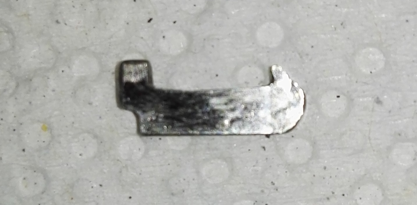

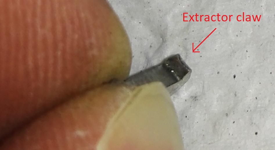

After grinding down a screw driver quite a low, I managed to take apart the extractor. I cleaned the entire bolt and extractor parts completely.
I looks to me like the claw of the extractor is broken off. I have ordered a new extractor from the manufacturer. Hopefully this will resolve the issue.

With the new extractor replaced it will spit the cases out of sight. The missing sharp end is the secret.

Yeah, that looks pretty suspicious. Glad you got it out without too much drama. Putting the new one in should be quick & easy.
Before installing the new one, check it for any burrs, and make sure the hook is nice & sharp. If it isn't, LIGHTLY stone the nose. Don't remove any significant material from the back of the hook.
