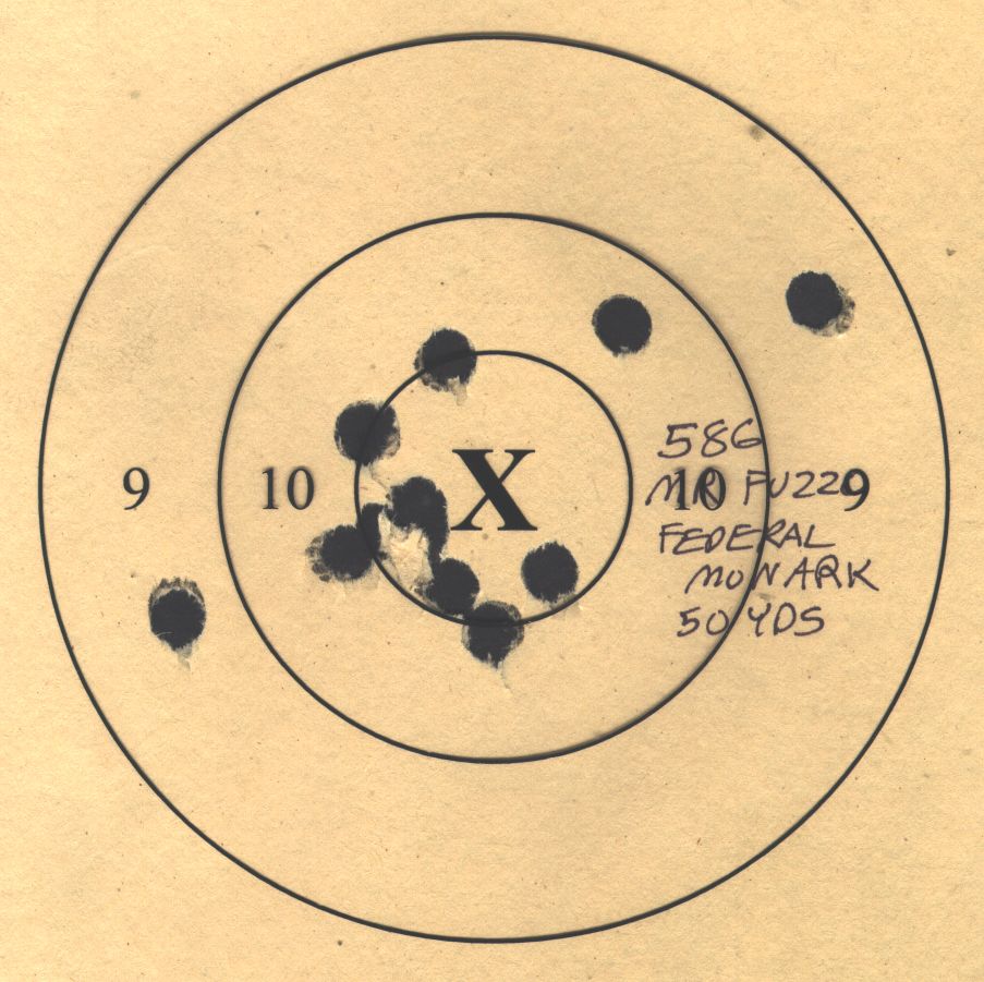

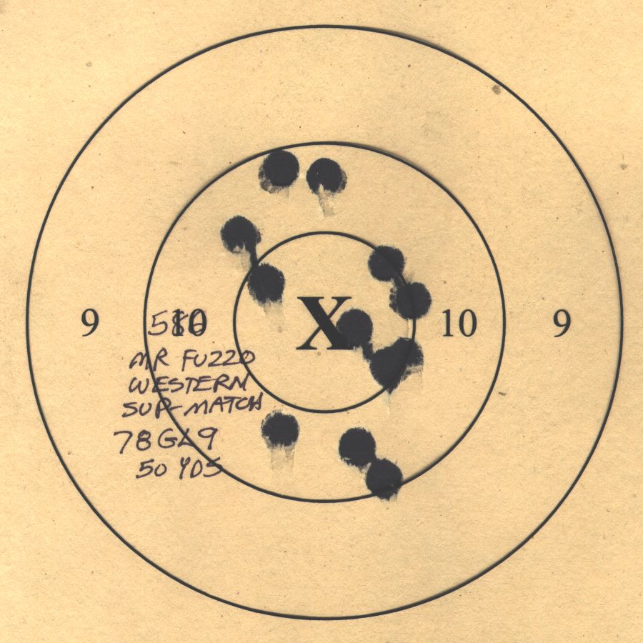

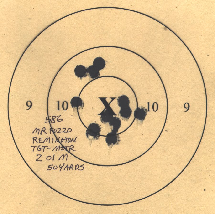

Greetings,
Some Random Rest targets fired at 50 yards with my friends 586 with a four inch barrel.
The ammo is various 148 grain HBWC Commercial Match.
I did test a second 586 with 158 grain Lead Round Nose and it also shot ten ring at 50 yards with good ammo. Sadly, I did not save the targets. This gun was a six inch barrel.

Wow...great groups! With a four (4) inch barrel to boot! Thanks
