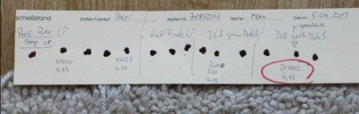

Probably not worth worrying about inherent accuracy of air pistol unless you're going to miss out on X count.
Image Image
