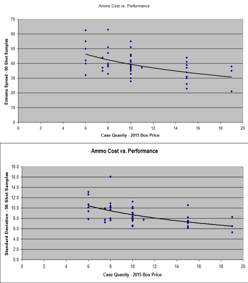

As they say, a picture (or two) are worth a thousand words.

I'd suggest you find the best ammo you can, low ES and SD, then tune the rifle to that ammo. Isn't looking for ammo that shoots well in an untuned rifle then tuning it a sub-optimal approach? It might make sense for selecting a brand (Eley, Lapua, or RWS) that matches your chamber, but beyond that... Just as selecting ammo that shoots well out of a rest rather than the stock you will be using would seem to be sub-optimal. If adjusting the receiver bolt torque can make a difference, then why isn't the stock a critical part of the system?
Bottom line, there are too many unknowns which result in conventional theories that are contrary to common sense. We badly need a scientific method to quantitatively establish the physical laws. Until then, find the best ammo you can. The really good stuff doesn't need a lot of tuning and will likely shoot well in your rifle.
