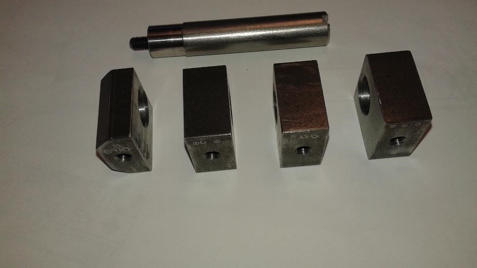

Here is what I made for the weight rod and weights. Nothing to fancy, but thought I'd share what I made since I asked the question. Pics attached. I chamfered (beveled) the front edges of the first weight so that it'll fit fully under the check piece. There's room on the rod for 3 additional weights if necessary. The rod is .5" diameter- but I had to turn the diameter down to 12mm so it would fit in to the hole in the cheek piece.
Rod=65.5g
larger weights= 54.0g/ea
total weight= 270g if all weights are used.
I also made a weight for the forearm stock- no pictures of it- maybe later tonight I'll snap a couple a post them. That one added another 362.0g. I also made 3 separate weight in different sizes to make it lighter if necessary.
FWB Weight Expl.jpg (53.22 KiB) Viewed 1123 times
FWB Weight Assy.jpg (49.65 KiB) Viewed 1123 times
