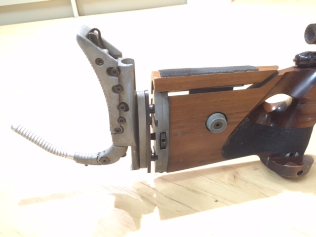

Came across this thread only today and just had to check my 2 Anschutz rifles I have. The one I shoot regularly (at least twice a week) is a 1981 vintage 'Super Match mod 1813' as clearly displayed on the barrel and butt hook that can only be swiveled sideways.
My second rifle is a 'Match 54', 1979 vintage, serial number ending in 'X'. Woodwork identical to the Super Match but with a more elaborate butt hook that can also swivel upwards. I'm guessing this is one of the intermediate experimental 1600 models?
Anschutz 1979 'X' Butt

Yes the '79 vintage Match 54 is a 1600. These were introduced some time in 1976-'77, and replaced by the 1800 rifles in 1980. Compared to an older 1400 Match 54 the 1600 has a faster locktime, and a more sophisticated trigger. Anschutz lightened the firing pin and spring to make it faster, but also tried to stop it acting like a piston, and compressing air by milling a slot in the bolt. The slotted bolt was dropped for 1800 rifles, but these have an even lighter firing pin and spring, backed by a stronger secondary spring around the indicator pin.
That 1600 barrel might not be in the original stock if it's identical the 1813. 1613 stocks typically have a rounded triggerguard and slot-headed bedding bolts without the stacked washers found on 1800 rifles. The buttplate is a later 1813/1913 model introduced by '84.

Looks like I have a 1813 stock with 1600 barreled action then. Bedding bolts are not slot headed, in fact same as the 1813.
You are correct in that the bolt does have a slot as compared to my 1813 which does not.
