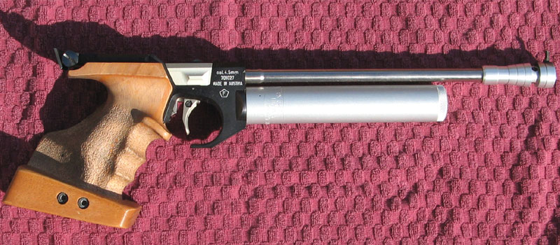

Hey guys I finally decided to buy an LP10E, but now I'm stuck on compact or long. I have a fwb 103 that I love and I'm making the leap to pcp. I shot a 537 today which I was happy with. After reading into the compact vs long it seems like the compact would be a good fit for me as I don't train a ton and am very inconsistent with how much I shoot. Sometimes I can't hold in the 9 ring and the compact may make it seem that I am. However, I love my fwb and its long. So what are your opinions? Thanks

Keep in mind... The LP10 has three positions for mounting the front sight. If holding it at full sight radius is difficult, you can always move the sight to the rear-most location (closest to the breech), which should approximate the sight radius of the compact model. Move the sight further out as you get used to it.
Below is about the longest sight radius you will ever see on a 10m air pistol (390mm, or 25mm longer that the LP10 Long). It's a diagonal, sliding-rub fit within the ISSF control box, and the sight post is nearly at the end of the flip compensator. Yes it is a challenge to hold steady... And yes, the shorter cylinders help with the balance.
