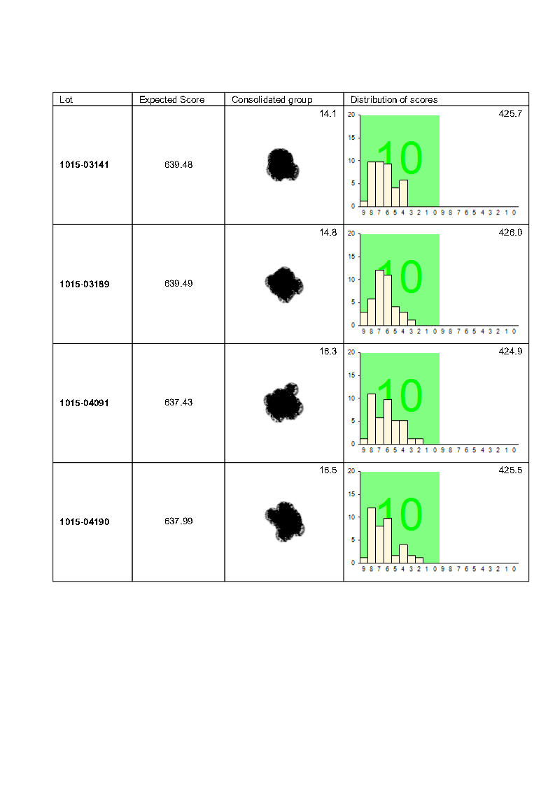

A test took place at Eley, UK recently which shows some interesting results.
Unusually, the complete stocked rifle which comprises a Bleiker Challenger, Lilja stainless barrel and a GE600 Evolution stock was tested in a recoil rest.

Just in case anyone was wondering, the consolidated score and group size shown in the target data is based on x 40 shots (which is the Eley protocol). The predicted score shown on the LHSof the data table represents what the likely total would be over x 60 shots. So, 639.48 effectively means an average shot of 10.65.

I don't see where they listed the test distance. 10 meters? :-) Must be hard to remove the burn marks on the target from the muzzle blast.

patriot wrote:I don't see where they listed the test distance. 10 meters? :-) Must be hard to remove the burn marks on the target from the muzzle blast.
Mark
Eley test at 50m, what's interesting is that it's from a recoiling rig. Normally it's barrelled action clamped in a vice.

remmy223 wrote: Eley test at 50m, what's interesting is that it's from a recoiling rig. Normally it's barrelled action clamped in a vice.
Testing outside the stock never made sense to me. The rifle is a system. Why would I want to buy ammo that's tuned to just a barreled action. If the ammo has a low SD and ES, then I use tuners to get it to shoot in several rifles.
