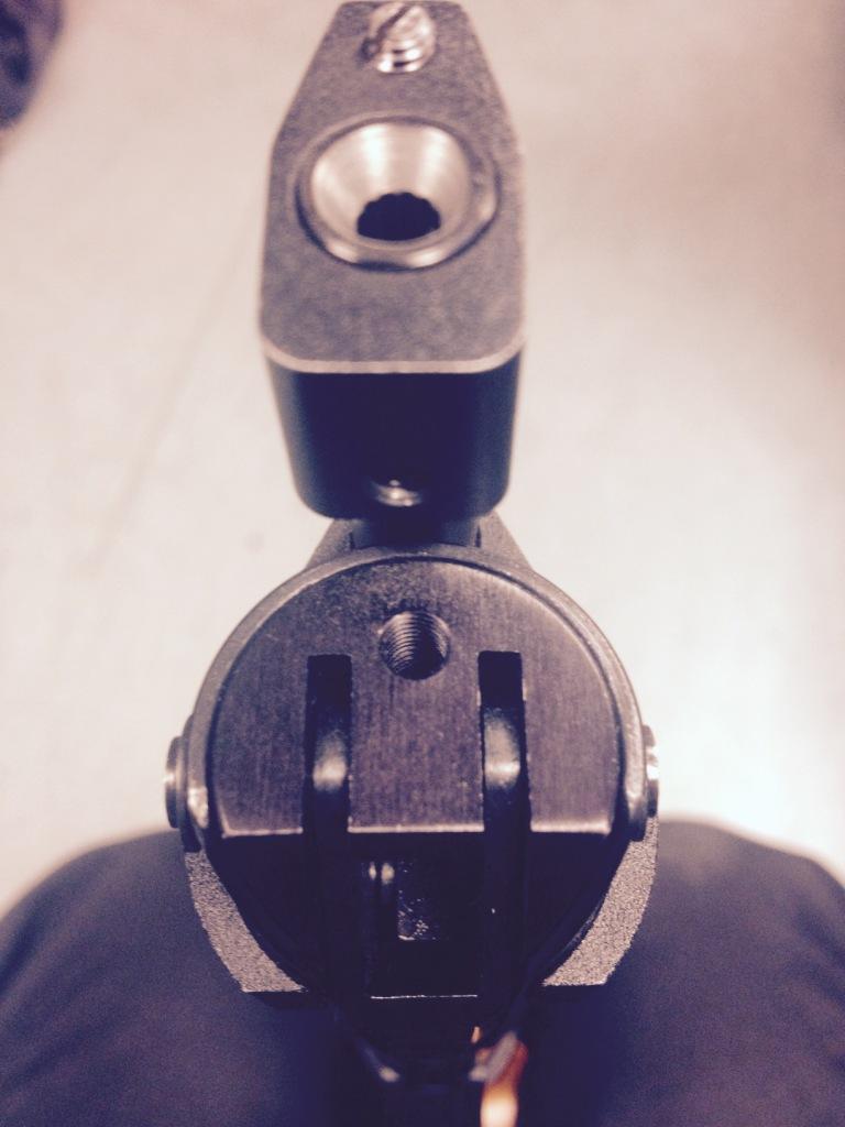

There is a threaded hole in the end plug of my Baikal MP-46M. Does anyone know what it's for?

I just looked, and mine also has one. Never noticed it before...............

Wynne G Oldman wrote:There is a threaded hole in the end plug of my Baikal MP-46M. Does anyone know what it's for?
The threaded hole in the end plug is for attaching weights on the pistol, but the Baikal is already front heavy...
Thanks for the reply. I had considered this as a possibility, but I've never seen any for sale, or fitted to a MP-46M, and as you said, it is already front heavy, so why would you want to.
