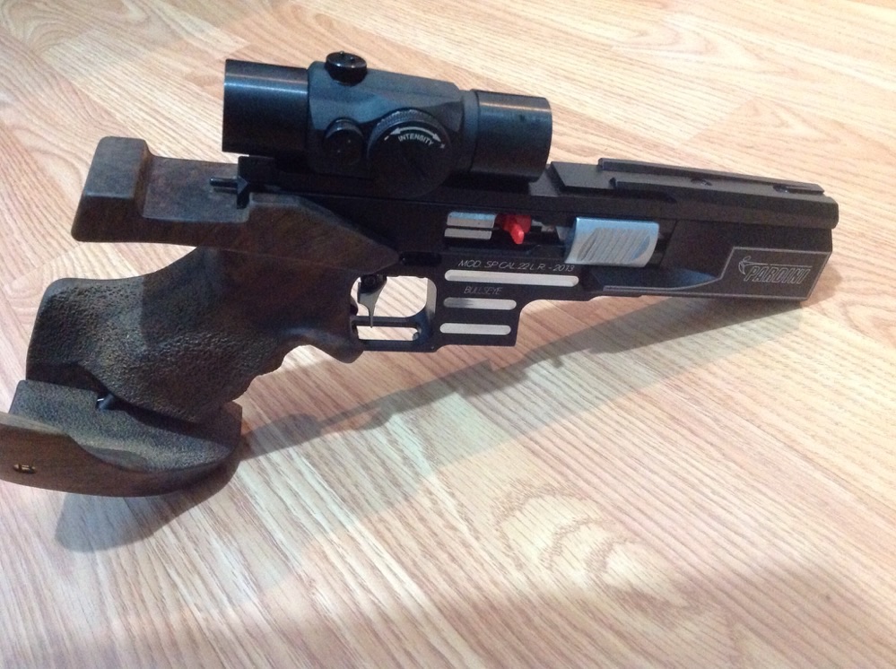

The LGI part mounts to the barrel shroud. So, when you break it down to clean, the rail and optic remain attached to the barrel. I have used this for two seasons and it hled perfect zero after breakdown. In the picture, you will see that I also modified mine. I wanted my red dot to be very low so I had the rail milled down and my Aimpoint bolted right to it underneath. For use with Ultrdadot you'd leave the rail stock and use some low profile rings. This particular style of mount is nice if you want to use the gun as a conversion 32. You can leave a red dot mounted to each barrel and be assured zero is always correct. I have two, one on the 22 barrel and the other on my 32acp barrel. I can switch them over in a minute and be shooting right away and know the zero is exactly the same as last time.
