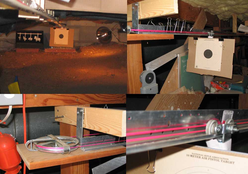

GaryN
Posts: 637
Location: California
Re: DIY Target Retrevial
Post by GaryN »
Depends on distance and what kind of clearances you have.
Mine is 10 meters, under the house, and with virtually no vertical clearance/slop. So I made a rail out of some drywall metal pieces and a wheel assembly from a hanging door. And a hand crank eliminates hassles of an end-switch for a motor.
