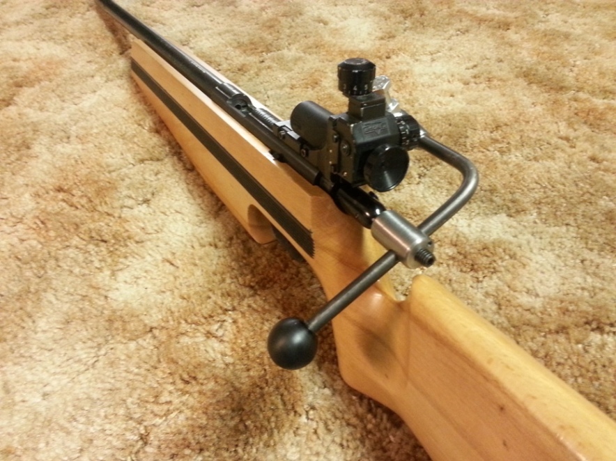

You could do something like this on a 1903 junior gun
