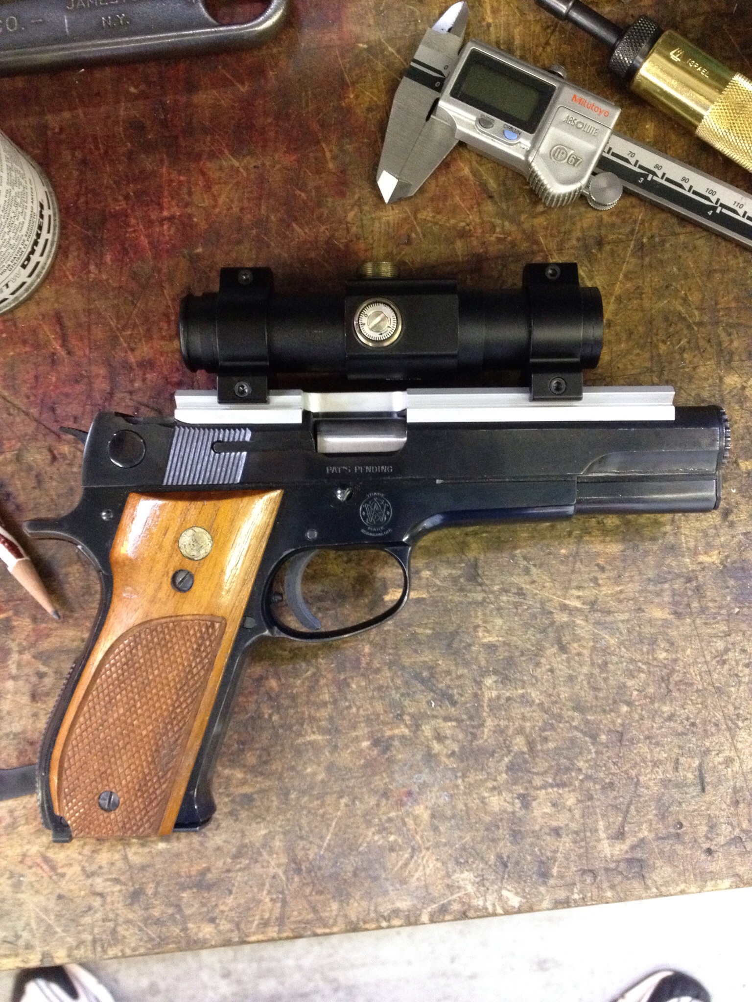

[attachment=0]image.jpg[/attachmentA friend machined this mount for a red dot, for his model 52. Quite possible to mount one.
