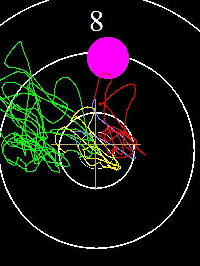

OK I have been shooting SB for a couple of months now and done a lot of shooting with the SCATT. All the SCATT results tell me (Shift and Co-ordination Graphs) that I should be releasing the shot ~1 second earlier than I am.
Given, on the whole, I am holding inside the 10 and my POI could actually be anywhere (but generally high and a little right), are the graphs representing my poor triggering or that I am holding too long or is it a symptom of poor shot release and an indication that it is taking me ~ 1 second to trigger the shot having seen the 'ideal' sight picture/hold?
The really annoying thing is that the trace, before and after the trigger are all inside the 10 with the POI as far out as the 8 ring (but usually no worse than a 9.5).
Cheers
David
Cheers
David

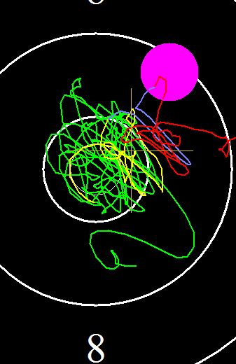

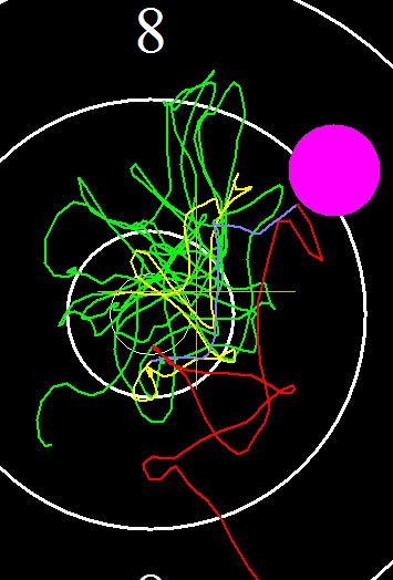

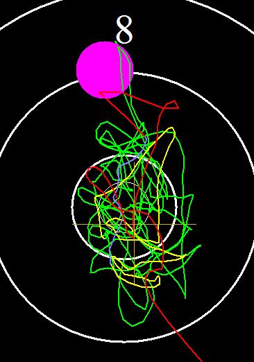

Re: The last 1 second.....
Yes I have it set to 40. Here are a range of samples (I can't find the one I popped off into the 8 ring - I might have deleted it in disgust.....)
For me that looks like you don't have you NPA in the middle. You see that the red line is very close to where the shot landed and that red line is where you are sighting after the shot and that is for me a indication that when your muscles relax then your muscle swings to a place near the where the shot landed. I find that on the SCATT the shot travels further away than if you did the same mistake in real life.
The gray line and the red line should be at the same point as your shot.
Hi, You have a very good hold, but it appears you are holding too long. When the hold is inside the ten, the shot should have been released.
Possibly some time spent learning how to hold more pressure on the trigger, earlier, to aid in having the shot release effortlessly. Good luck.
Hi David, it's difficult to be sure from static traces but I'd suggest there are a few areas for improvement here...
Firstly, are you holding too long? Probably yes. I'd suggest that it would be good to go from the entry point of the trace into the bull right through to the shot release in the 5 second window of your SCATT capture time.
Secondly, is there a trigger issue? This is more difficult to tell. I'd respectfully disagree that your hold is particularly good for a prone shooter - it's about what I would expect from a Club standard shooter. On some of the traces there seems to be a rhythmic movement which would indicate pulse transmission. On others the hold just seems a little "loose" which may be due to insufficient relaxation, using muscle to steer the rifle onto the target or just a generally unstable position - or even using a very small foresight element and hunting for the right sight picture.
Shots that jump out of the hold pattern like you are seeing happen because the barrel is moving quickly across the target at the moment of release - like shooting ON the pulse rather than between them. I'd guess that you're getting "L" values of 70 to 90mm which could definitely be improved upon with a little trial and error...
So what to do about it?
My suggestion would be
1) doing some Progressive Muscular Relaxation exercises to make you more aware of the inner tensions in your position with a view to minimising them. Relaxation is key.
2) Playing around with the point that the sling locates on your left upper arm. I have found that getting that right can dramatically cut down the disturbance caused by pulse which results in a smaller hold pattern and fewer shots out of the hold pattern. For me, higher is better. Low and medium sling positions produce pulse.
3) THEN look at your triggering.
Just my 2€...
Ken.
Just my 2€...
Ken.
The shape of your pulse looks to be quite long in the 3 o'clock to 7 o'clock directions.
I have just spent the last 4 weeks working on the shape of my pulse trace. Initially I worked on trying to get my L value low but found what was more important for my scores was to have a high % 10a figure. By adjusting hand stop and sling position I managed to have a 10a figure close 100% but my L value was quite high around 50. My L value was hight because my pulse trace although long wiggles around a lot more but it's doing this inside the 10/10.5 ring. Where as before I had quite an oval shape to my trace from about 3-9o'clock which went outside the 10 ring each side. This was pushing the shots left and right but my L value was around 40 yet 10a only around 75%.
The Scatt is a great tool to tuning your set up. Make sure you make a note of your current set up so you can return to it. Then just go for it with the changes and fine tuning make sure you take lots of notes of what you are doing and any improvements. If you don't take notes you will just get lost. Play with handstop position and offset, Sling tension, height, how tight the sling is around the arm, also try central pull on arm and also pulling from the outside of the arm.
As Ken said your hold could be a lot better but its doesn't sound like you have been shooting long so this is something that will improve maybe on it own over time. But it would be worth trying different foresight elements to see if that helps your hold.
Difficult to see why the shot is so far away from the centre of aim without seeing the scatt file. But look at NPA, relaxation, and also shot release.
I would say your F coefficient is a little low at 40 I am using 70 for prone. I have seen quite a few Scatt files from international shooters and they are around 65-70 for the F value. I have a Scatt MX-02 and when live firing F value at 70 is about right and seems to be quite accurate to where the shots actually hit. I am afraid 40 will make your shots look better than they are. Also better to be too high than too low with F.
