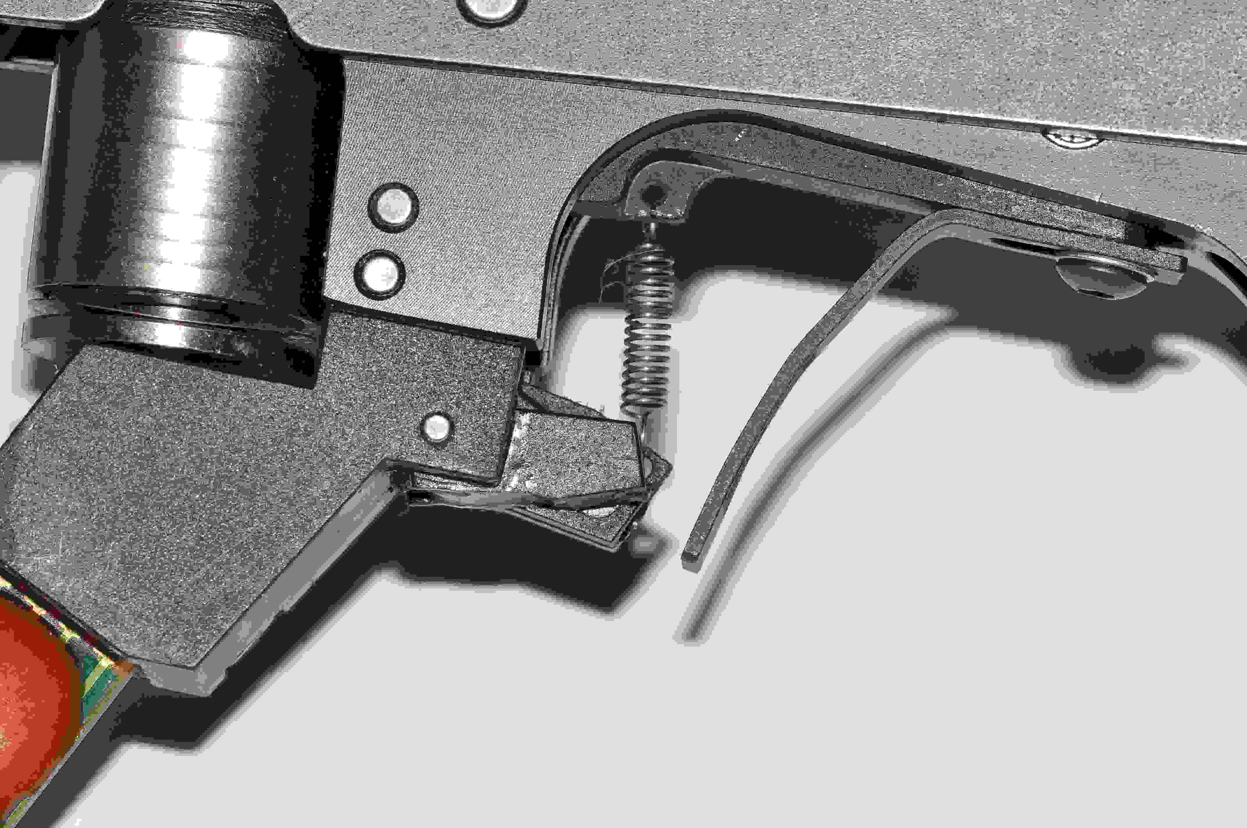

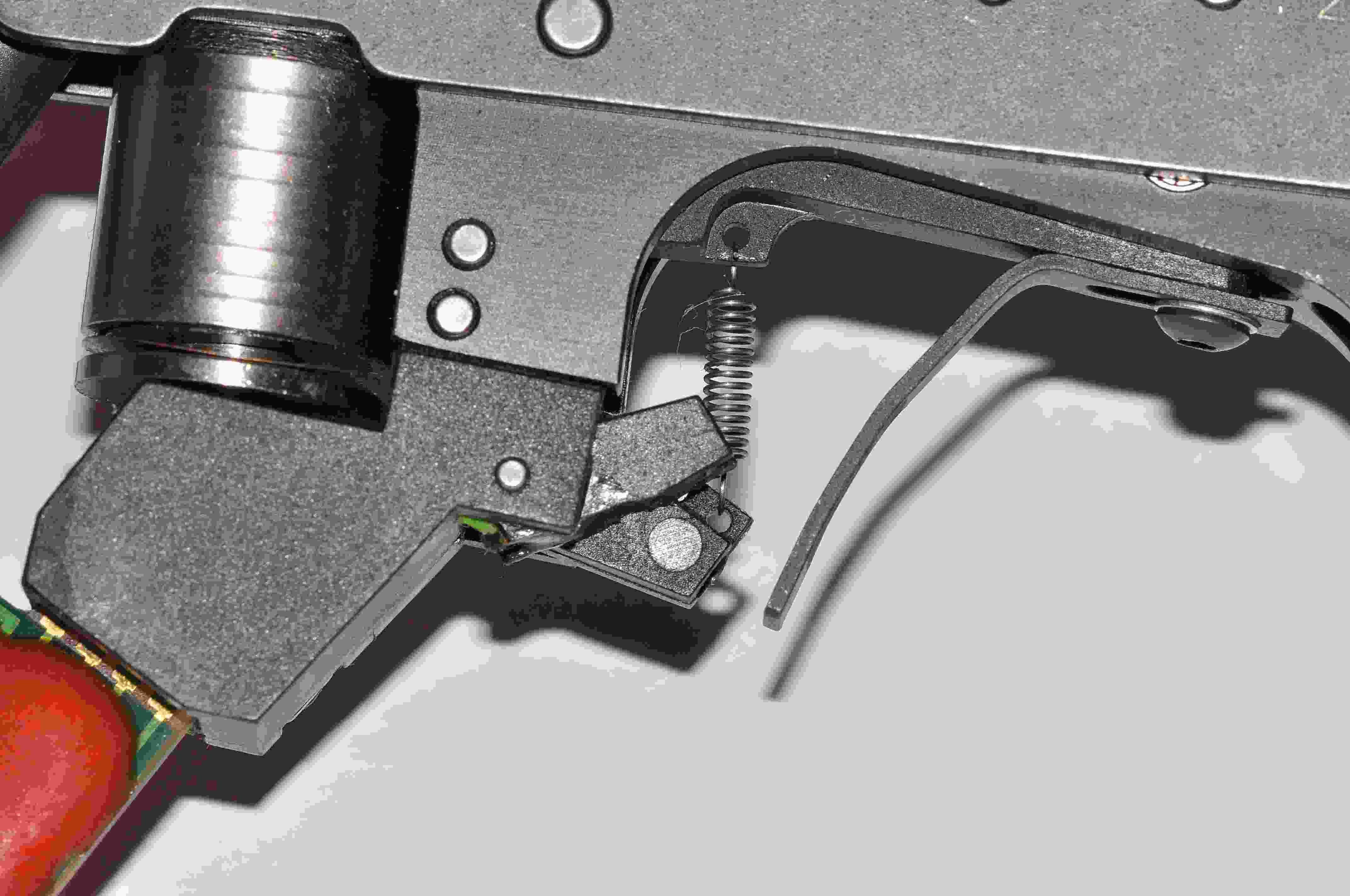

I may have found the reason.
I removed the action from the grip to have a close look at the workings and found that the infra red receiver had rotated and was not receiving the light beam from the emitter.
This would have the same effect as having a finger on the trigger as far as the safety was concerned.
I'll glue the receiver in place at the correct angle and test it at the range next time.
Top photo shows the correct angle of the IR receiver and the bottom photo shows the elevated angle as I found it.
