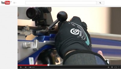

Ulrich Eichstädt
Posts: 187
Location: Dortmund
Post by Ulrich Eichstädt »
Tim, I know the Martini actions from BSA very well, having written many reviews, also about the Martini action itself (in general, also in pistols etc).
I was more thinking of the loading procedure itself, with moving the lever under the gun, then putting the cartridge into the port: much more down and up with the right hand.
Anyway, Martinis don't seem to be a solution in my opinion.
And if you watch the videos from the ISSF finals, you will surely see, how some of the shooters try to shove the cartridge into the chamber, with the help of the fingertips and a lot of fumbling. And certainly no smooth transfer without too much contacts of the bullet tip before entering the chamber.
For example in the Final 3 x 40 Maribor:
https://www.youtube.com/watch?v=ej780Ya ... e=youtu.be
here especially minutes 1:40 to 1:50
