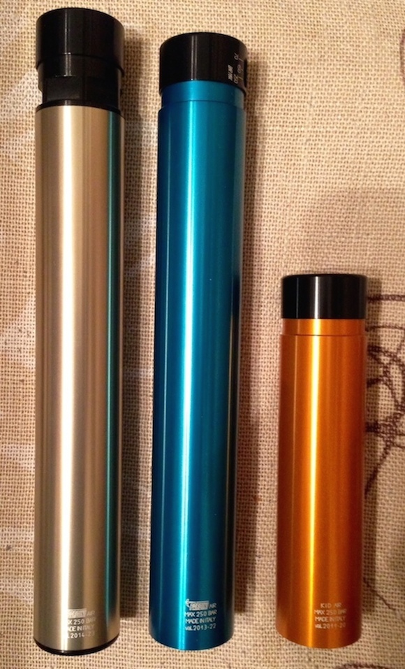

Avery
Posts: 31
Joined: Thu Apr 05, 2012 2:36 am
Location: Russia Moscow
k12
Post by Avery »
2014 type filled weight about 256 g
2013 type filled weight about 206 g
Kid type filled weight about 146 g
k12 without cylinder weight about 800 g
