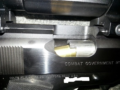

Just got my reworked (barrel, bushing, slide tightening) wad gun back from the 'smith. Yeah! Having problems with it not going into battery. Boo!
Seems like the rounds jam going into the chamber. Happened about 15 times in my first 75 rounds of factory Federal 185gr GM45B (not set up for reloading yet). Tried every mag I have. It only happens on the 4th or 5th, last, round in the mag. If I put that round back in the mag and try again, sling-shotting the slide, it has always fed fine.
Tried both the 10# spring the smith put in, and the original spring of unknown strength (though it is 1" longer than what the smith put in).
The COAL of the Federal (SWC) rounds is shorter than the handloads the 'smith used, 1.163 vs 1.267 (LSWC) and 1.229 (Zero JHP).
Sometimes I can give a forward assist to the of back of the slide to chamber the round.
Every time I've racked it, the round has come out so it's getting under the extractor.
Ideas anyone? I would really like to shoot it this weekend in my first ever NRA match and the 'smith is on vacation!

Jabberwo,
If that picture is your jam problem, then I have lead you astray. The jam I got with my gun was the last quarter inch before lockup, not 3/4" like you have depicted in the picture. Yours is a feed issue, not a lockup issue and you might need a longer bullet with the lighter return spring. Sorry for my mistake

Post by Jon Eulette »
Looking at the photo you submitted it appears that the roll over point (where the case transitions from the chamber throat to chamber) needs more radius added. The case side wall is getting caught as it tries to make the transition. Look at the side of the case for a minor dent from getting stuck/jamming. Sometimes if the extractor is too tight it can also cause this to happen. Chamber depth from hood to case mouth should be about 0.905". Remember that headspace is combination of chamber depth and gap between breech face and hood.
