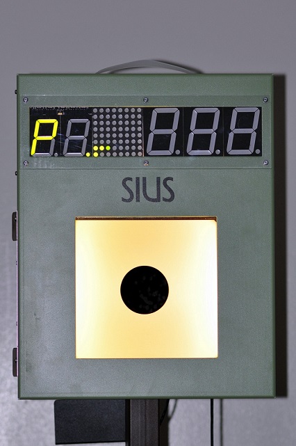

Sius Hybridscore
I have been using my Sius Hybridscore for about 2 months in my home range and I love it. The price was $1995 and I had to provide my own computer for the display. It's still not compatable with Windows 8 at this time.

We have been shooting on the SIUS HS-10 Hybridscore since May. We choose this device over the Megalink because of the cost of the paper rolls. Also, we chose this device over the Elite scorer due to the fact that, in the US, the Elite Scorer had a temporary lower price for rifle shooters but not for pistol shooters, and it does require feeding: paper rolls.
With the SIUS there are no paper rolls to deal with/purchase for volume shooting. However, they can easily be added as needed, for scoring records. From a cost standpoint, the SIUS Hybridsocre is a great value when compared to the available options. The SIUS HS-10 Hybridsocre 'lights up' nicely in a dark basement, as well.
As of August, 2014, we have also updated our device with cabling and Windows 8 software and it has become even easier to use.
