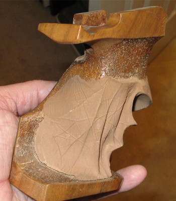

The Tuf-Fill Mahogany product mentioned earlier looks similar to what the pros use, is easy to carve, and does not get too hot when setting... you can actually put a glob in the palm of your hand and grab the factory grip. 10-minutes later, you pry your hand loose and it leaves behind a perfectly molded impression that a palm reader can interpret, but more important it usually requires little filing or carving. Add and delete material with ease.
As noted previously, I made an entire grip with it once (top photo).

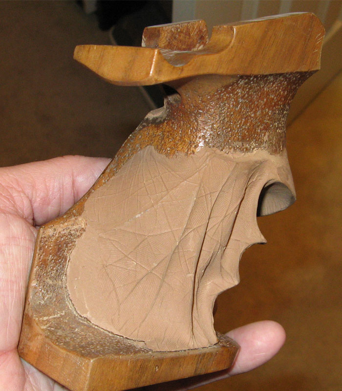

sounds like quickwood or something similar is what Rink used on my grip. It was a kneadable epoxy. By putting on a little at a time and then molding to hand and then blending to what was already added, we didn't really have to take much off with the dremmel tool. Setup in about 2-3 minutes and I think was fully cured and could be ground like wood in about 5 minutes. Was brown in color but I'm not too concerned about how it looks. You can see every line and fingerprint with the stuff just like in the pictures that were posted. Unfortunately I don't need a gallon (or at least I hope not). I think Larry's sells the same stuff at Tomas Rink but wanted to pick something up locally. Guess I should of called Neal at ISS to see what he has in stock but it's still a 25 minute drive. Thanks for all the replies. I see there is definately more than one way to go and just about any of it should work.
