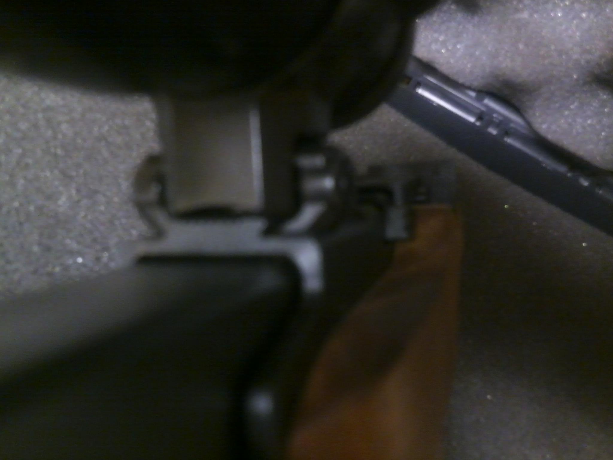

I purchased a Benilli 95E and found a Tasco Pro point on Ebay and the rings that came with it I believe were tasco rings every thing was still in the org box, worked very well and everything was quite reasonable it was used of coarse but very little and I fined it to be a very good scope for the money. The rings never loosen up. Can be taken off and gun cleaned and reinstalled with maybe two clicks to zero.
Like Fred B said the milled area in front of chamber wont fit nothing. I not recommending this but it was done to my gun before I bought it. It had two slots milled deeper across top of barrel it doesn't loss any integrity and doesn't inhibit the weapons operation. if one would think he had to mount a scope that for forward. I like mine crossing the chamber although ejected shell cases do hit it but doesn't interfere with operation. Pictures hopefully attached. Can't seem to be able to get two attachments to go.so milled area picture will have to wait.
Jim..
