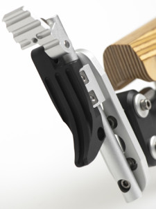

Aktiv buttplate
I take the recommendations are stronger for the Aktiv buttplate than for the standard buttplate?
- Aktiv buttplate.jpg (38.15 KiB) Viewed 4503 times
Re: Aktiv buttplate
Yes because you can adjust it more to get a better fit. Just be mindful of the rules should you shoot ISSF competitions. In that case the upper curve of the buttplate can only extend rearwards 25mm.artandscience wrote:I take the recommendations are stronger for the Aktiv buttplate than for the standard buttplate?
Rob.
The standard buttplate was developed to meet UIT rules for 10m air rifle and 50m standard rifle, as an improvement on a basic rubber buttplate. You can certainly use it for 50m prone; it's used with Gemini fullbore/palma rifles as GB-NRA rules do not allow hook butts for this discipline, but it won't give you the same fit as the Free rifle butt, as it is much smaller and lacks the facility to offset the butt laterally or cant it.
Rob is quite right that you have to watch the curvature of the heel (top) plate. Gemini free butts now come as standard with a double joint, what they call a cantilever. The heel plate generally won't meet the ISSF's 25mm depth rule with the cantilever inserted. It can be removed very quickly with a 4mm allen key.

thanks
Yep.. I'm familiar with that rule as I've had to be careful in the NRA for my fullbore matches (I use a standard Gemini buttplate for my Palma guns) and have had competitors complain about it (25mm rule).
I'll give the Aktiv a try.

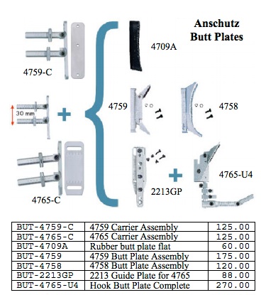

Aktiv vs. standard buttplate vs. Anschutz 4765-U4
I use the standard buttplate on my fullbore rifle (.308). It does indeed flatten during recoil. However, the set screw only allows it to flatten so much and so it still works (when adjusted properly).
I think I'll sadly go with the Anschutz 4765-U4 as pricing out the Aktiv with Robert came to over $500 with the current exchange rate.
However, I'm not quite sure that it will be a savings unless I can use my current 1413 carrier with the 2213 guide plate and the 4765-U4. Anyone done this?
If I can, it will save me about $150.. I think at least one person said that the 4765 assembly doesn't give up anything to the Aktiv buttplate?
Thanks,
Stefan
Thanks,
Stefan
Stefan,
you should not need to replace the existing extension rods to fit the 4765 butt. If the 2213 guide plate does not fit directly, you could remove the vertical rod (onto which the 4765 butt clamps), and fit the rod directly onto the 1413 extension.
As for 4765 v Gemini, I think the Gemini is better, and offers a closer fit, especially at the top of the shoulder, although with the ISSF 25mm rule, the difference is lessened. This is not to say the 4765 is bad; I would much rather have the 4765 than the original 1413 butt.
