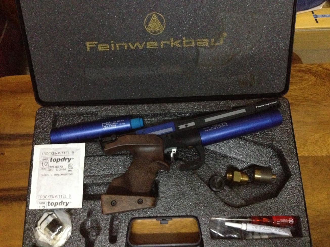

I found one used FWB P34 for sale around where I live. The price is good, judging by the pictures it is in mint condition. Seller says it only fired a few shots.
I will go and check the gun in person however both air cylinders are empty and there won't be a chance to live-fire a round or two (no shooting ranges nearby).
Will dry fire be a sufficient check trigger-wise?
Anything special I need to be careful about, known faults? I am prepared to replace the seals and other smaller things.
Thank you!

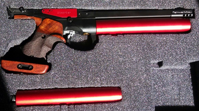

Here is my toy
