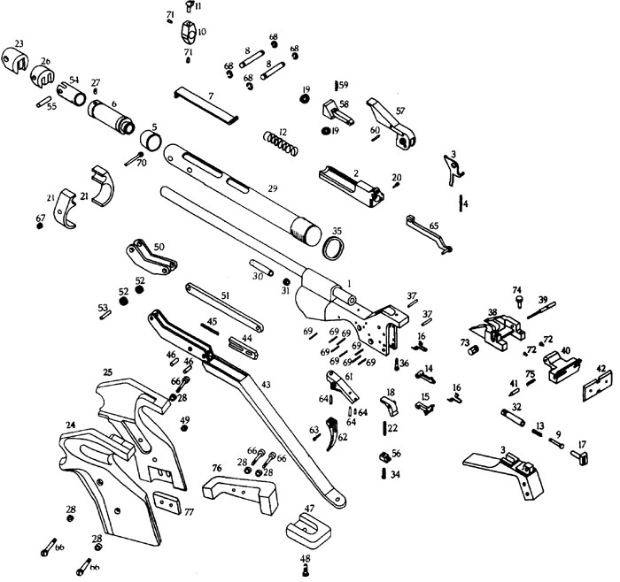

That's odd. As far as I can tell from the exploded diagram & everything I've read & seen, the IZH has NO O-rings. All the seals are odd cross-sections, nothing round.

46M replacement seals kit from Pyramydair has one piston cap seal, one large 0ring, three beveled seals (two large, one small).
I know where to put the piston cap and the two large beveled seals on the lever clap. But where to put the large 0ring and the smaller beveled seal?
Posts: 3569
The large O-ring may be the seal for end of the piston tube, and I think the small beveled seal is the inner firing seal. The exploded drawing shows a circular seal for the large piston tube, but it's drawn like it has a square cross-section, which technically isn't an "O" ring.

seamaster wrote:But where to put the large 0ring and the smaller beveled seal?
Those two seals you mentioned are the packing ring (part nº 35) and lock (part nº 31). I prefer FWB special grease, rather than using oil to lubricate the seals.
http://www.pilkguns.com/tenp/izh46ex.htm
