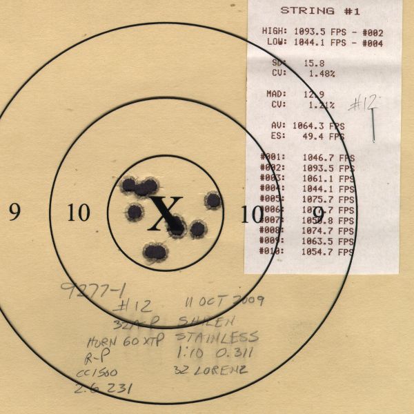

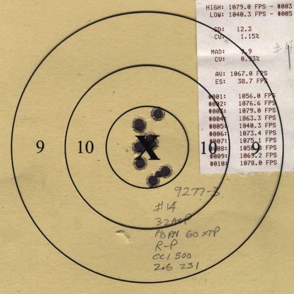

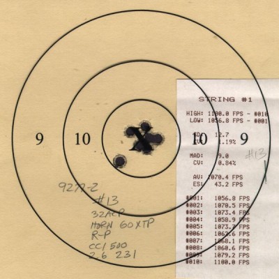

Greetings,
I located scans of some test targets I fired at 50 yards back in 2009.
The velocity is near maximum; so, I would try to bring it down to 900-950 FPS.
