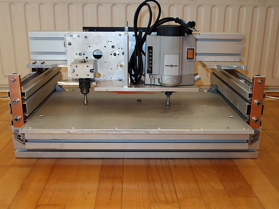

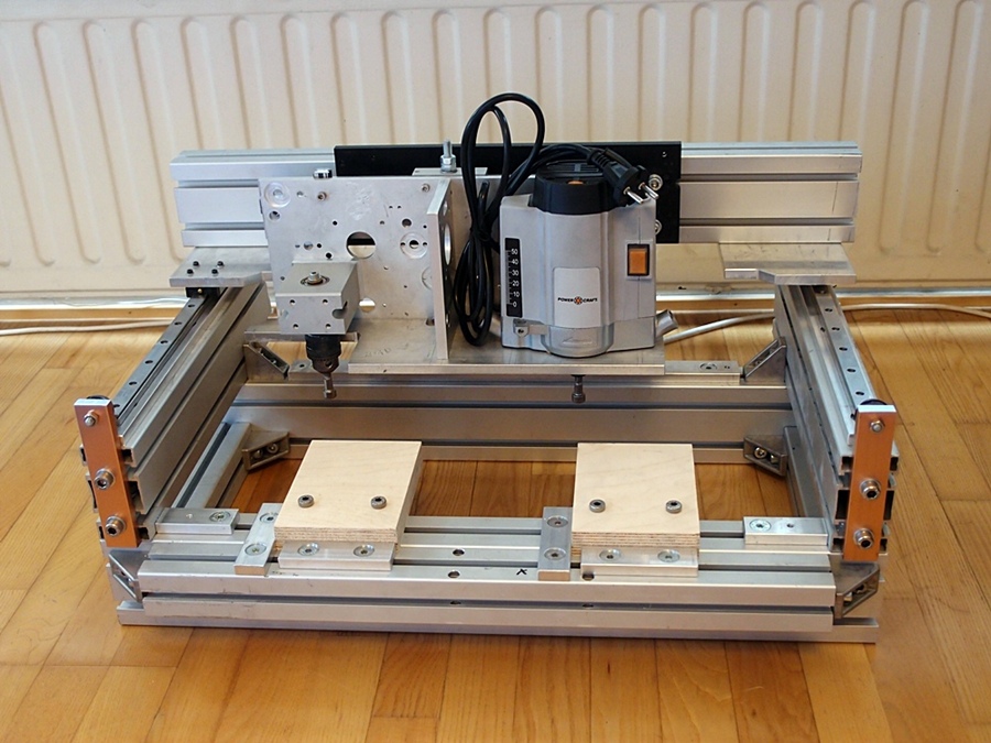

I have seen pictures and videos about copy routers used for copying rifle stocks and other wood parts - but not for copying match pistol grips.
I wonder why... So I made a copy router for pistol grip sized parts.
Almost all parts I used were scrap, left from disassembling some old machines.

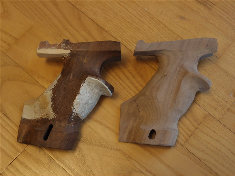

I have two Benelli mp90s pistols. I used to swap the grip between them, but maybe soon I´ll have grip for both. Also the original grip of .32 pistol is broken. I have shaped it to better fit my hand. Lots of filler.. When shape is right I can copy the shape to wood.

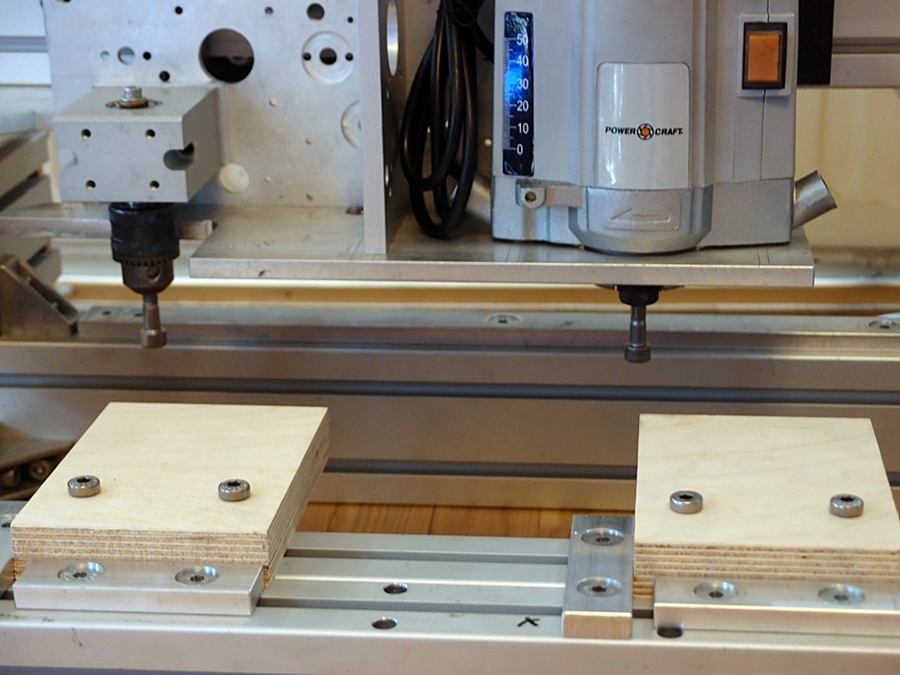

Next I have to make templates for cutting the inside of grip.
Then make a fixture to hold the old, shaped grip and the fresh piece of wood to be shaped. Plan is to use those pieces of 1" plywood for that.
Socket head bolts were used to adjust the positioning fixtures, they won´t work when cutting wood :)
Do you guys have experience with this kind of machines?

JiriK wrote:Do you guys have experience with this kind of machines?
You might improve the capability of the machine if the pattern and blank can rotate.
http://www.youtube.com/watch?v=PUr5IFXNT0A
As you have probably discovered, set the stylus lower than the router bit because the new piece will always need sanding.
With a good setup, a duplicating router can mill the inside of the grip, too.

I have made two grips so far with my machine. Have to say it´s messy business...
First one was not so good, broke during shaping but is usable.
Second one is better.
How is that rough gripping pattern (stipling?) made?
