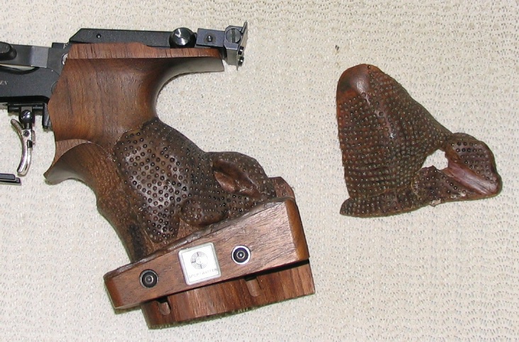

IPshooter
You need to use Fimo or Sculpy 2 found at any craft store. You can mold it, but it is not soft. You bake it to harden. You can sand or drill, or add additional layers. You can use it as a permanent solution if you want to, or you can heat it again to remove it. Can be stained to color match as well. Here are the 2 pieces I did for my LP10E
