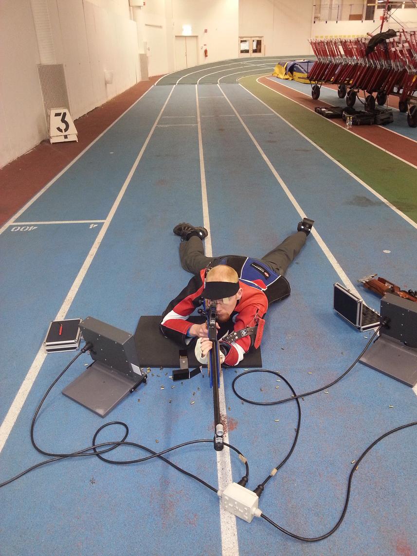

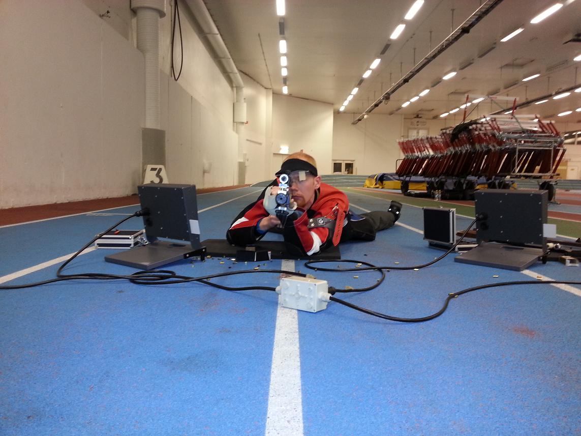

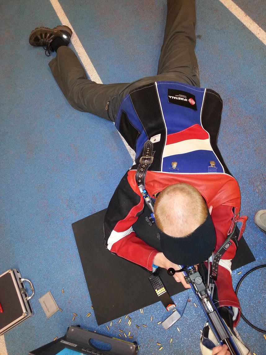

Here are 2 pictures on my "new" position. They are little bad in quality though.
Ligg
Ligg

Ok to me the sling looks too short and it's pulling you round and the left arm under the gun. So your shoulders and hips should be parallel to each other and perpendicular to your spine - yours aren't but it's hard to tell how far off because you can't see through the jacket. I'd suggest take off the sling - lengthen the buttplate then get yourself in position. Get someone to put the gun in to you and then set the sling to the right length.

RobStubbs wrote:Ok to me the sling looks too short and it's pulling you round and the left arm under the gun. So your shoulders and hips should be parallel to each other and perpendicular to your spine - yours aren't but it's hard to tell how far off because you can't see through the jacket. I'd suggest take off the sling - lengthen the buttplate then get yourself in position. Get someone to put the gun in to you and then set the sling to the right length.
Rob.
Okay, can you explain why I should lengthen the buttplate? I ask that because I must know what it should do to know when it's right.
Posts: 2060
Johan,
I'm going to disagree with Rob slightly. I think that your shoulders are square to your spine. As you say it's not a good photo (but not a bad one either). It's your back that is slightly bent, so your hips are too much to the right.
My observation is that your left elbow is the problem. It is too far to the left, so the position isn't stable. I am puzzled why this would make the rifle fall to the left; this is normally a sign that the elbow is too far under the rifle. Try repositioning your elbow so it's nearer the rifle, maybe 7-10cm, not the 12-15cm you mentioned in your first post. Also make sure your left elbow is as far foward as possible.
Tim

May I make an observation, to me your right shoulder is higher than your left and you appear to be putting too much balance onto your left side which will make you "roll" to that side.
I am not a coach but would try reaching further forward with your left elbow and try bringing your right elbow a little further forward. Try to get a bit more stable possibly getting a little lower with the left elbow further forward and maybe lengthening the handstop.
Have an honest look at some of the ISSF photos, not the extreme ones but the average ones and compare with your front on one.

Since everyone in cyberspace gets a chance to comment on your position, I will add my observation. In the second photo (looking down), it appears that your eye-head position is not allowing you to sight on a straight line through your rear sight. There is a significant angle with the rifle-bore axis to the left. It is as if you're not directly behind the gun, possibly due to sling being set short and other factors.

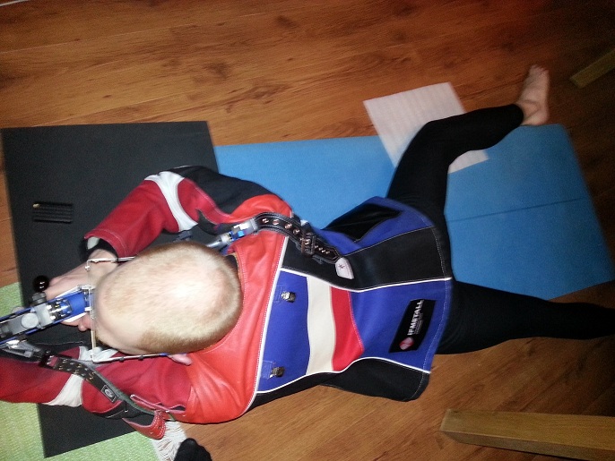

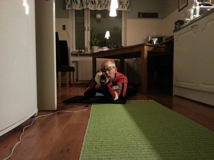

I was at the range yesterday. Made some small adjustments on the buttplate and sling. Finished with a 199-8x with a 9,9. I got really nice recoil and if I don't do anything wrong (have tensions etc.) it returns exactly to where I was aiming before the shot.
I am at 20 degrees angle now.
Here are some pictures.

Looks ok to me, so if you are getting consistant results, I would stick with it for a few weeks, before thinking of any changes.
