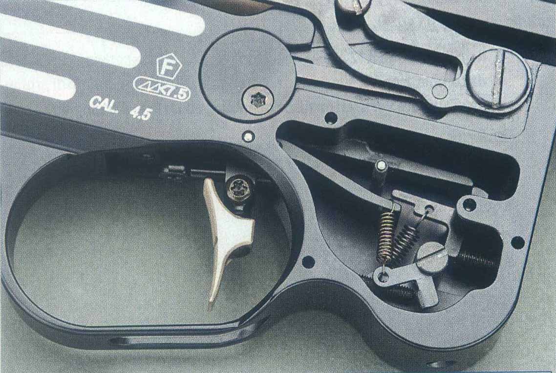

The K12 trigger has a different feeling. Clean but much more easy than K10 (which wasn't better than K2s, IMO). You can see why looking at the picture here (different design, angles, levers, etc.).

Thank you for the images. But couldn't you do something to increase your depth of field? f128, perhaps ;-)
jipe
Posts: 812
Post by jipe »
These picures aren't mine, they come from: http://www.all4shooters.com/it/Gallerie ... rdini_K12/

Regarding the magic trigger of the K12, which seems to be clean, silky, short, but also easy and controllable, I think, well, I'm sure that it is due to the invention of Roberto Di Donna (DiDo) and Pardini himself (who was also a shooter, in the '70s).

K12. I've seen new cylinders, they are already are out, easier to unscrew. Same weight. Also the trigger mechanism - as far as I know - had some refinement. The point of contact between trigger lever and second lever is much more clean (little iron ball is there).
