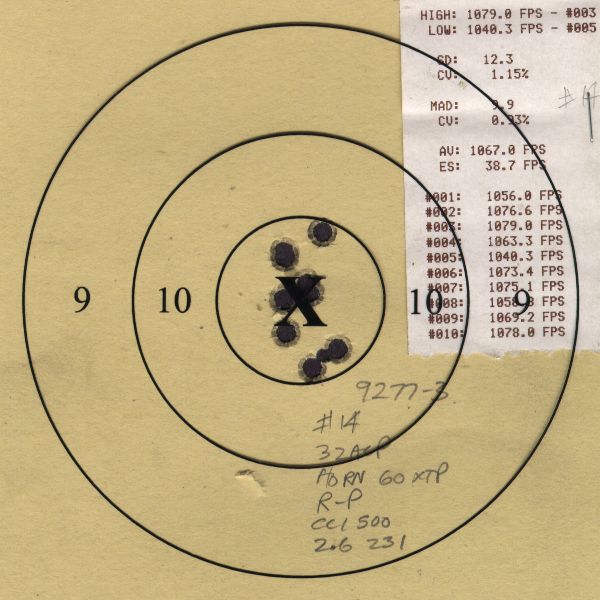

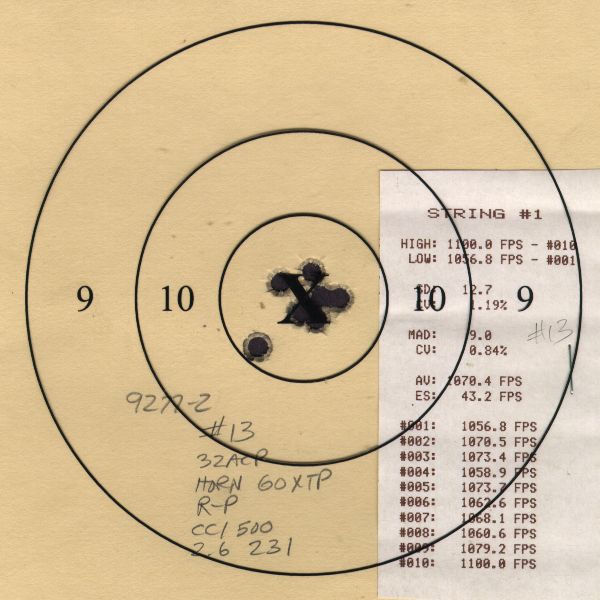

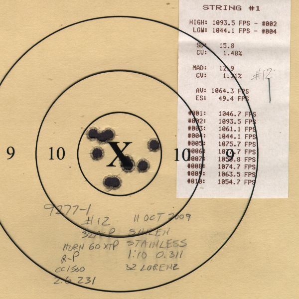

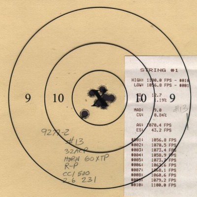

I machined a barrel for a fellow a while back in 32 ACP. He had me remove the barrel and install the original as he kept breaking extractors. It was a Pardini HP
Nonetheless, the barrel shot well. Photos attached of 50 yards groups.
Personally, I would stick with the 32 S&W Long Wad Cutter.

Dave, thank you for posting your test targets and data. Our test with the lot that was developed have similar results. Best group .7 inch, average 1.1 inch at 50 yards.
About the issue with the extractors K. broke with your barrel: the problem was that he was using the standard 32 S&W bolt. The diameter of the rim is different and that is why a specifically machined bolt face for 32ACP is required. I sent him a 32 ACP bolt for tests and he did not have any broken extractors while using it.
