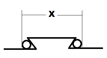

All of the FWB, Walther, Anschutz dovetails (except Walther front sight) are considered to be 11mm. They are just a little different though. The FWB dovetail is about .024" (.61mm) wider than Anschutz so some of the older ANS sights that fit quite snugly on the ANS dovetail probably won't work on FWB. FWB sights would probably work fine on ANS, but who in their right mind would do that? The Walther front sight dovetail is quite a bit smaller than their rear dovetail for some strange reason. All of the mentioned manufacturers use 60* dovetails.
Older Anschutz front sights that fit on a sight block are not interchangeable with the newer ones that fit on a dovetail.
The only way to accurately measure dovetails is with precision pins of a known diameter and micrometer or calipers. Measuring the width of the top of a dovetail is pointless as different manufacturers have different height dovetails. They are still considered 11mm. Measuring the dovetail bottom width directly with calipers is also pointless because neither the caliper jaws nor the dovetail cutter itself are dead sharp...so what exactly are you measuring?
I'm not exactly sure what dimension these European manufacturers are referencing by their 11mm dimension designation. I just use the attached measuring method to make sure anything I make has dovetails that are the same as the manufacturer.

Once I get the rifles - I'll try to measure the dimensions with the caliper, but indeed - need to have round pins of predefined diameter to properly measure the angle..
