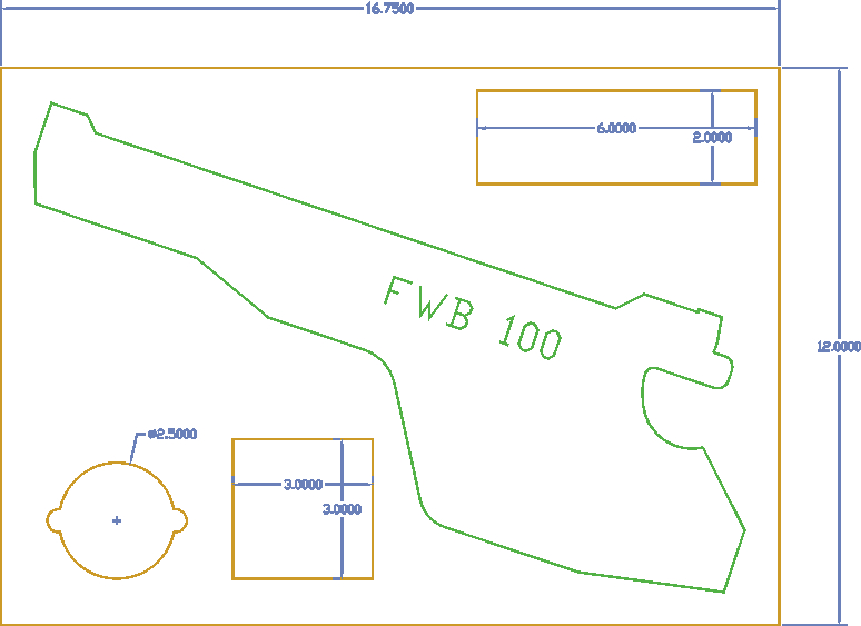

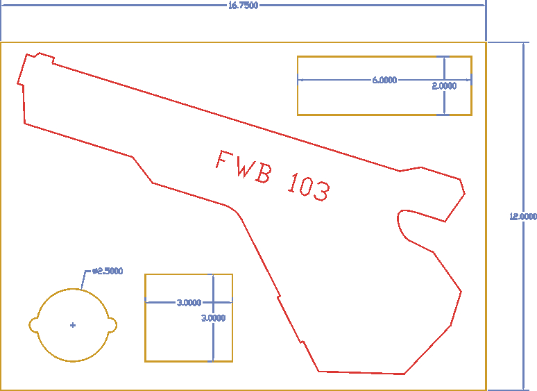

This size is compatible with the 100 and 103 i have drawn. I would also have cut outs for two pellets. My oem FWB case is close to this size . My goal is to have the foam pre-cut just like the origional FWB cases. The case i'm looking at can be ordered in black, off black colors and blues. I have had 2 izzy's and never traced them, i should have because i believe there are tons of people out there that would like a fitted case. Something like the drawings attached...

Have you thought of cutouts for tools, the white grease tube, etc.? It looks like there's room between the cocking handle and the pellet tins. What do you think of this idea? Is that what the square at the top corner is for?
Also, what is the potential of buying only the cut-out foam from you if a shooter already has a decent case with foam cut for a different style pistol?
Keep us posted on your progress. This is most interesting.

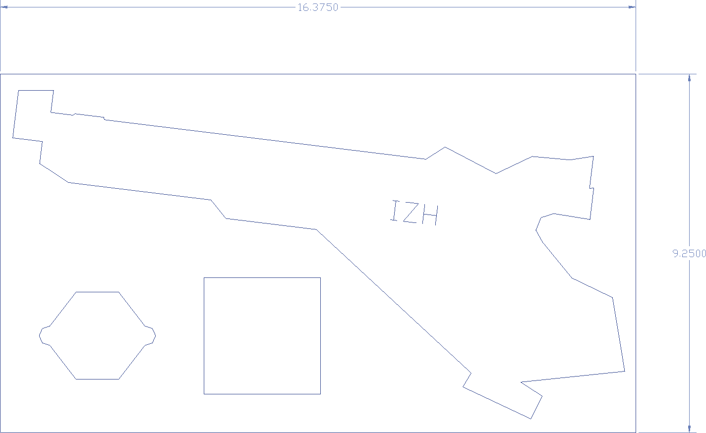

More mods...
Ok i hear you. Try these changes.. Keep the suggestion comming. I'm not to sure yet about the specifics of the inserts. I will keep you up to date..

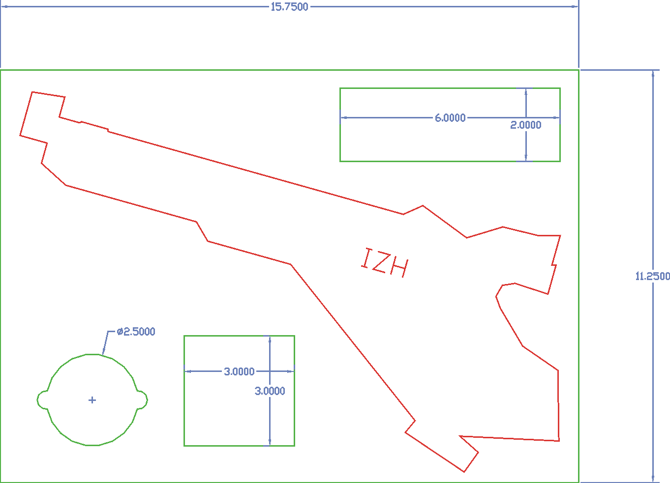

Smaller IZH case?

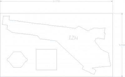

here's asmaller case that would work better for the IZh it's 3" thick..
You're going to want to keep plenty of foam between the front sight and the end of the case. Your layout of the 103 shows the foam being very, very thin under the front sight.
Once you pick up the case, and the pistol in held upside down, the whole weight of the pistol will be on that tiny portion of the foam (especially with the angle you've chosen) unless the sides of the cut-out foam grip the pistol very tightly.
I wouldn't want the slightest chance that the thin front sight blade could get bent.

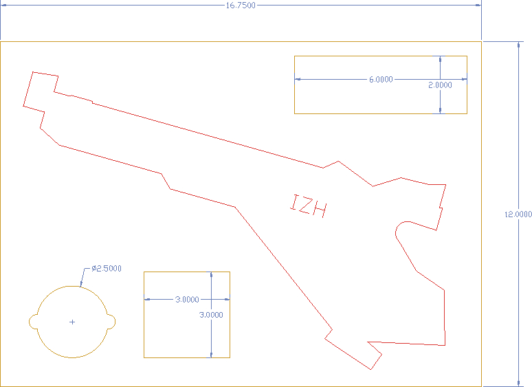

Great coments! Thanks! The foam holding the gun itself would be polyethylene (i believe this is whats holding my 103 in the oem FWB case)
and it is close to the edge, the gun has to be oriented that way in order to fit in the smallest "standard" case i've found (this is hard!)
Any way here is the latest version of the Izzy in a new case with custom cut inserts..

I think Brian's comment above about gun orientation in the case is certainly valid.
It seems that every single-gun case I've ever seen has the gun hang upside-down when carrying, and this might well place the sights in danger if you're trying to squeeze it into as small of a case as possible.
If the front sight is going to be so close to the edge of the case, you really ought to orient the cutouts so the gun hangs butt down and sights up.
Some of the hard cases shown in this thread aren't perfectly rectangular either, so simply turning the foam 180 degrees may not be possible if it's not cut to fit in the first place.
Most of the cases in question seem thick enough to allow stacking of two pellet tins in one deep round hole. Something to think about.
