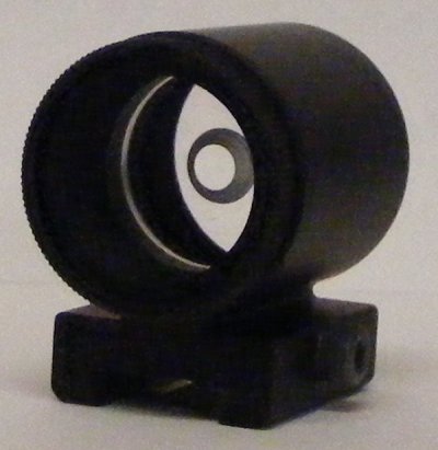

Hi guys, thanks for the help. I'm shooting an Anschutz 190(Canadian version) or also known as 1403. I do use the clear inserts with the hole in them.
What I'm trying to describe is when I align the tube that holds the lens within the peep. The bottom of the sight cuts off that perfect circle I'm looking for to align my sights. In the attached picture, it would be the square block at the bottom.
Hope this makes sense?

Now I understand what you are talking about. I really like the dark black rear ring on the front sight making it easier to center it in the rear aperture, but it would be easy to toss some paint on it to try to see if it helped you, and easy to remove if you don't like it. I think I'd try changing the color/brightness of the stuff between that ring and the barrel first, though.
