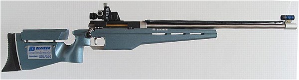

LOP is a compromise. For me I didn't get it perfect for any position, but it was closest for standing. I shot a Bleiker, with the angled rubber buttplate. You get an effective LOP adjustment when moving the buttplate up and down. I'm not sure what the guys shooting the new aluminum stock G&E are doing about LOP.

you mean the Blaker stock that has a angled "butt face" so by moving up the butt plate for prone increases the LOP and by moving it down for kneeling decreases LOP?

The buttplate carrier is mounted at an angle, and the carrier itself has a curved surface. The combination of those two things gives you a LOP adjustment between high and low BP position.
