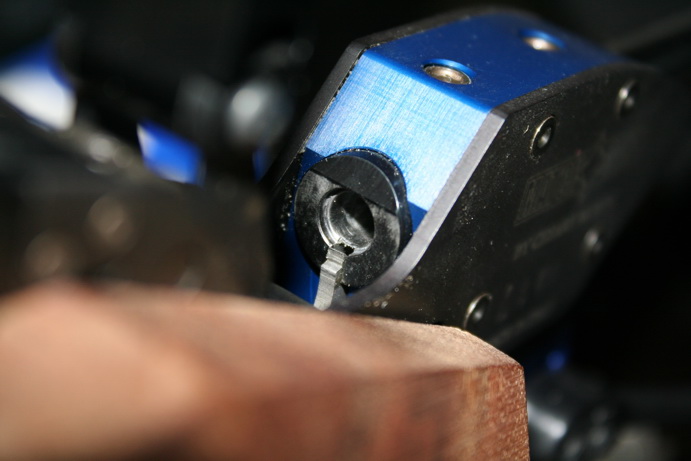

Pictures (regarding case rupture and extractor location) attached.
Freepistol
Posts: 773
Location: Berwick, PA
Post by Freepistol »
Gosh, Tom, your barrel looks defective to me. I don't think that slot should go in that far.

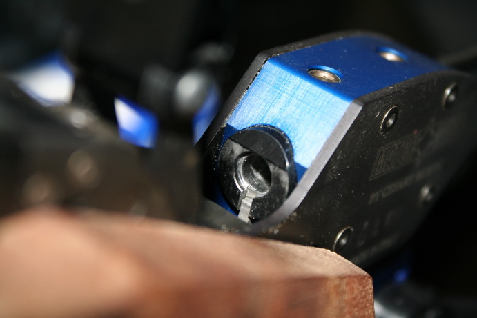

I agree with Ben (I believe it is Ben) in addition to what I emailed you. The notch that appears behind your extractor is much deeper than mine is and as I mentioned my ejector is almost flush with the end of the barrel and the case rim of the barrel. There is no empty space behind my ejector toward the front of the barrel.

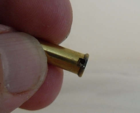

That gap might explain the case rupture - there is no support at that part of the chamber and the rupture looks to be about the size and shape of the gap. When the ruptured case was extracted, did the rupture line up with the gap in the barrel? If so, I think you have a pretty good case for a factory warranty repair.

Roger - that's exactly where the ruptures/bulges are; directly opposite the firing pin which is at the top of the bolt. I've only had a few ruptures (mostly because I quit shooting it after the first rupture except to test it), but every single case has an ominous bulge at the extractor location. Eley, with its thicker or stiffer brass, doesn't bulge as much, but it's still not a reassuring sight. Every single SK, Wolf, or Federal empty case is on the verge of failure.

Dont know how long you have had it , but i would be giving the chamber a good clean out, to help with the case seating properly.
Also have you extracted the shells by hand with by pushing your cleaning rod through the barrel from the muzzel end , that way you will know if it is the extractor cutting the hole in your case ,
if its the extractor i would say that a small amount has to be filed off, you should ask Matchguns if the extractor is a drop in part or does it need to be fitted by gunsmith ,either way thats just not right.

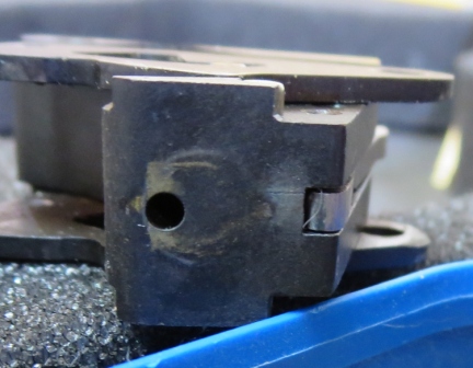

Can you show a pic of the bolt face?

Hi James -
The bolt face is simply a flat area with a hole for the firing pin.

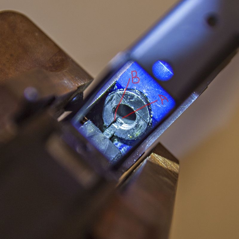

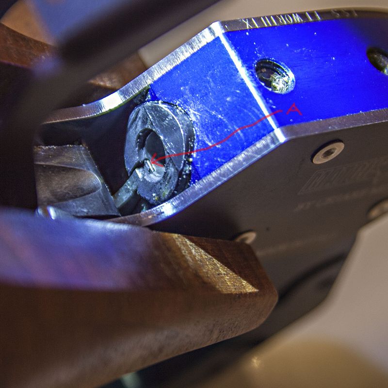

I investigated this some, last night. From your photo it appears the cutout for the extractor at the rear end of the chamber of your gun is a bit deeper than that of my gun.
Regarding "tight" chamber: I chambered, and then extracted, several unfired cartridges of different brands.
For some brands, the front "shoulder" of the bullet (front of sylindrical part of bullet) showed "bright" lead, from bullet being squized some by the forcing cone, in front of the chamber. At chambering the round twice, it entered chanber with ease. So, the chamber itself may not be extremely tight, but the forcing cone/lead may be on the short side.

my guess from my mg5 inspection is that in tom's mg5 the recess for the extractor goes too much in to the chamber leavening an area of the case unsupported. i am not a gunsmith but seems he may need a new barrel.

At the top of the frame, the barrel is fixed by two screws through the frame, each one entering a drilled recess at the top of the barrel. They are in fact porposedly entering this recesses slightly off-center. By unscrewing one screw some degrees, and then tightening the other, the barrel (head space) may be adjusted a few thousands of an inch forward or rearward.
If new recesses have to be drilled, they may interfere with the ixisting recesses. Which may be cured by rotating the barrel 180 degrees. But then, ther are the same complications at the front of the barrel. The compensator fixing screws at the front of the barrel enter recesses off center, too. The tilt (or no tilt) of the front-blade is adjusted by these two screws. ...
A competent gunsmith may be able to cut off the rear of the barrel a few thousands, then ream a new chamber. with a reamer configuration matching that of the orginal chamber, to avoid a step in the chamber. (There are numerous "chamber-reamer-standards" out there, with some variation in diameter and other dimensions.)
It can be done, but a new barrel may be a better fix. If a new barrel is obtainable.
