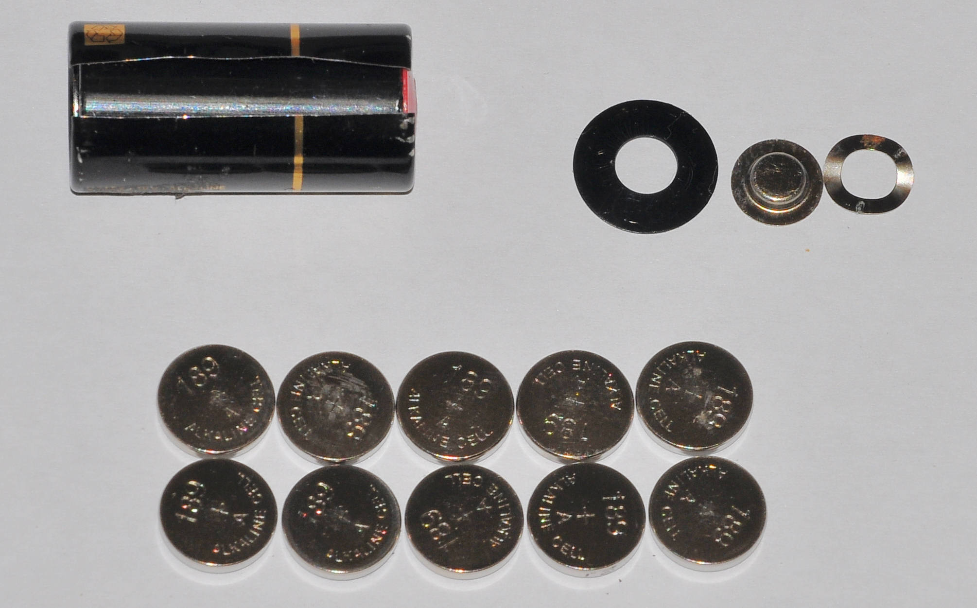

Yes - as Zohan noted, you can re-pack these quite easily. Nick the edge of the metal case and peel it off using a pair of pliers. Inside you will find a black plastic tube and inside that there will be ten x 1.5v alkaline button cells in stacked in series plus a conducting top cap with a nipple and a conducting base. All you need to do is find the equivalent button cell and buy ten of them. I worked out which one it was once but have since misplaced the code. It's no big deal though as it's one of the popular standard button cells and should be easy to work out. Fill the tube up with these, fit the top cap and base (make sure you get them the right way as I don't know how well the circuit will take to reversed polarity!) and tape it up with electricians tape.

This is what is inside the 15V battery. It only takes about 30 seconds to get them out.
You can get them on Ebay in packs of 10 for a few dollars.

Gwhite wrote: There is also a big difference between alkaline & silver oxide button cells. The ones in the picture look like ~ SR44/LR44 size.
If you wish to stack cells, take note of the correct type. They aren't SR44 cells, the size designations are as per the picture below.
