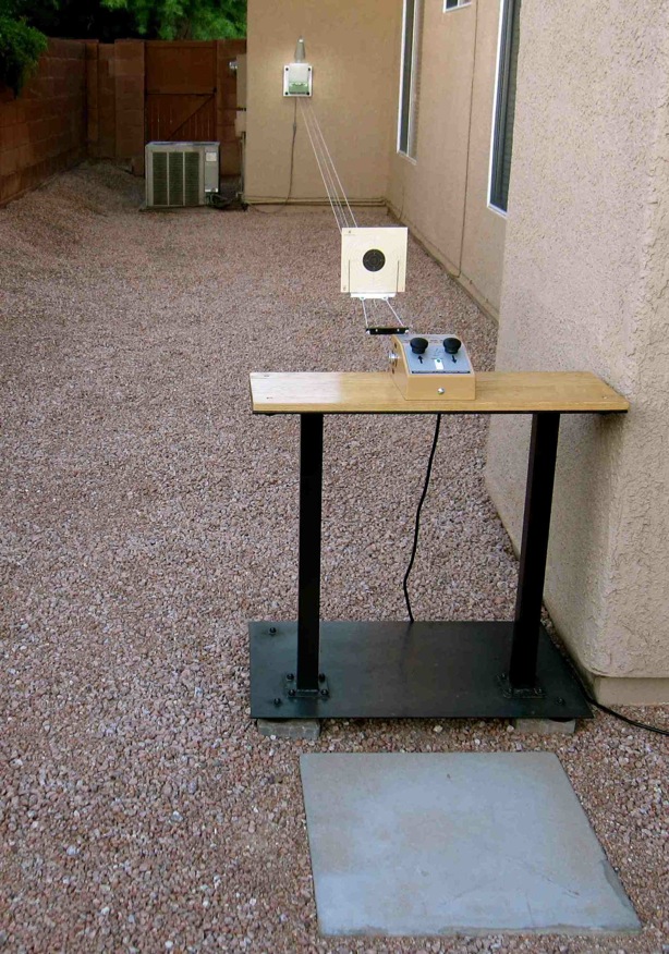

Arizona weather usually allows for outdoors training, although today at 107 degrees was pretty uncomfortable. I have ten meters on the shady north side of my house and can train year-round. The only way to have ten meters indoors is to shoot over the dining room table, through the kitchen, over the sofa in the family room and into the fireplace. In the interest of family harmony (and safety), I train outdoors. I also have six meters in my garage for monsoon season, and have appropriately scaled targets.

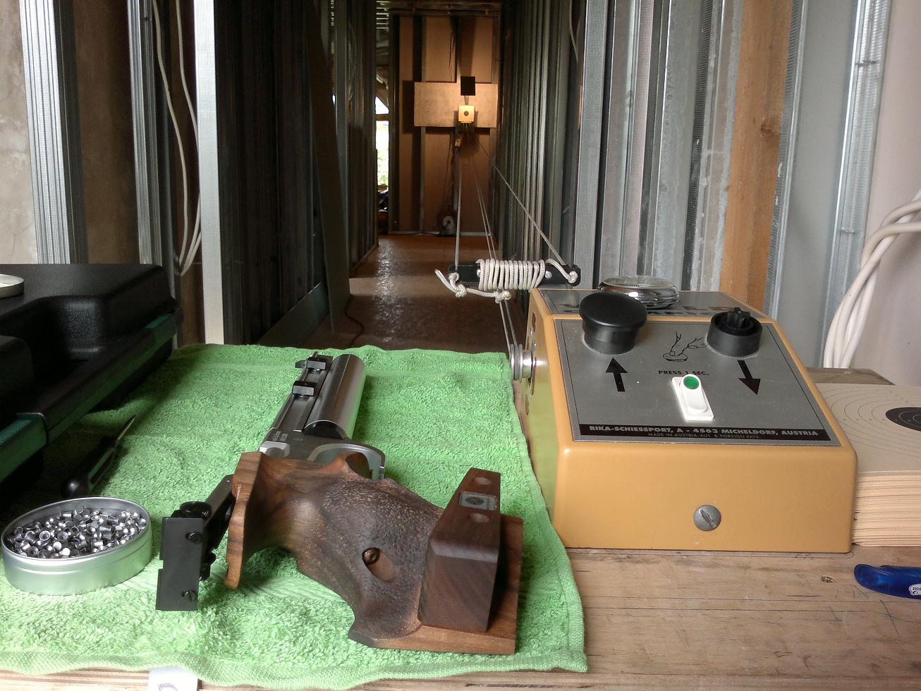

Here's my set-up in my downstairs basement. I'm lucky to have a spare room downstairs with a door which leads into the dirt-part of the basement. The first thought that went through my mind when my wife and I first inspected this house as a possible purchase three years ago was "AIR PISTOL RANGE!!!". It took some time to put together but the cost was minimal.
Here's the nice discreet "entrance" to the range as seen before I set up. The black tape on the floor is the 10m mark for my foot (the splodge on the door is a recently acquired dust speck on my camera's sensor - dammit!).
Here's how it looks after i have set-up (takes about two minutes) with the target carrier brought fully back. The black box on the stool has a rocker switch in it (double-pole, double-throw, momentary on-off-on) which moves the target forwards and backwards. The 4-core cable runs from the switch box to the motor unit which is tucked up behind the top of the other side of the door frame
And here's my view of the target when shooting. In reality the target appears much brighter than this but you get the idea. It has a couple of cheap halogen lights down the end to illuminate it
What I did to avoid the nylon cords getting in the way of all the other things I do in the basement was to run them up high with the target holder dropping down to the correct height. Here's the shuttle suspended on the supporting cords (white) and attached to the driving cord (black). To make the shuttle I used bits of aluminum purchased from the local hardware store which I riveted together with pop rivets. The rods coming down to which the target carrier connects are some sort of welding rod which are very stiff and ideal for this purpose. You can actually invert a commercial target changer in the same manner though you still need to be able to reach the controls (or duplicate the controls and run a cable). With this system I can walk underneath the cords (and I'm 6') without hitting my head on them until the point where the head space narrows about four metres in.
Here's the motor unit attached to a bit of wood screwed into part of an old metal bed frame which sits above the door frame. The motor is a 12v unit (a car ventilation fan motor) which I bought from an auto wreckers for $8. Window wiper motors can also work well. You can see the 12v power supply up in the floor joists. There are two blocks of closed-cell polyethylene foam to act as buffers with another two down at the pellet trap end. I know when to take my finger off the switch but occasionally the shuttle rams into the buffers but this has never resulted in any problems. With this motor, the shuttle and target holder move fast!
To connect the target holder which is made of a lighter gauge welding wire to the heavier gauge rods connected to the shuttle, I used the metal connectors which I cut out of a plastic electricians connecting block. I've used four of these (two for each side) which means it is easy to adjust the target holder to the correct height.
Finally my cat who insists of running into the basement whenever he gets the opportunity (I think he's hoping to catch a mouse down there but he hasn't had any luck so far). He occasionally sneaks in to sleep on the old wool carpet you can see that I placed over the dirt floor where the head space narrows. The carpet makes it more pleasant if I have to crawl down to the target trap. I have to be sure to shoo him out before I start practicing. He is a beloved pet, so perish any thoughts that I would even think of using him for target practice!
