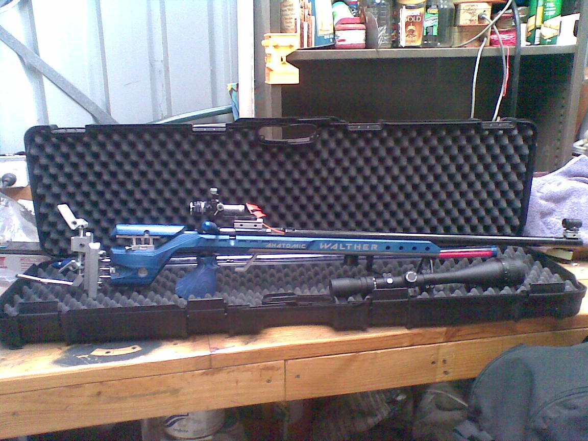

Hi Tenring, I just put my old 1813 in a Walther KK300 Anatomic and I'm rapped, it's got all the adjustments of the Precise and the softness of wood :)

KIM wrote:Hi Tenring, I just put my old 1813 in a Walther KK300 Anatomic and I'm rapped, it's got all the adjustments of the Precise and the softness of wood :)
That's pretty much exactly what I'm trying to do with my 1813. Just been waiting for ever for the anatomic stock <ordered last year> :(
